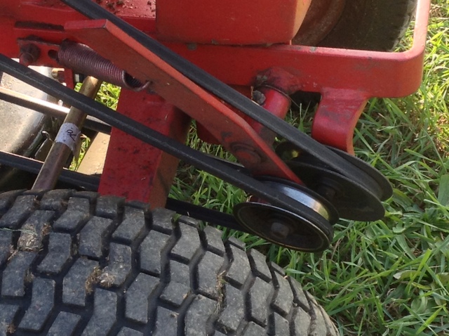

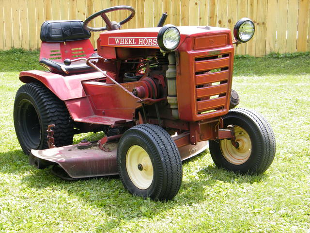

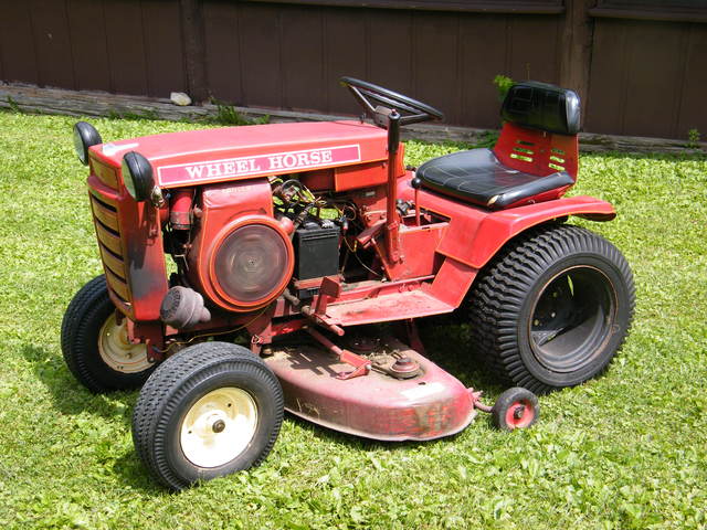

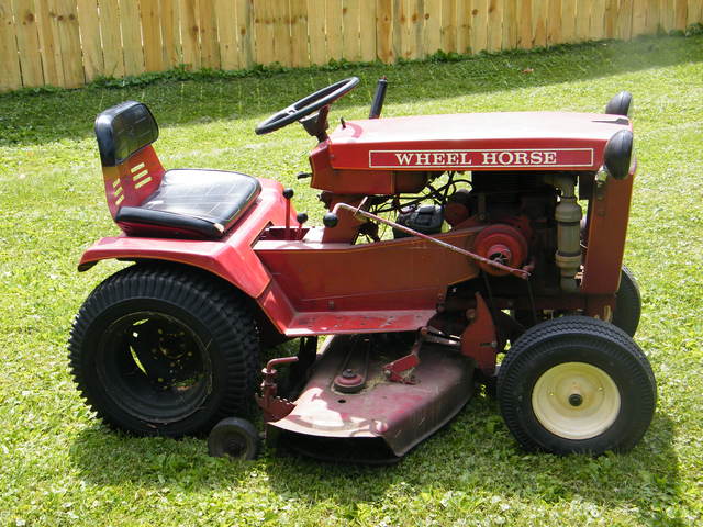

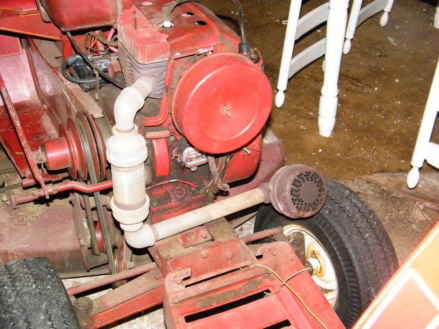

Klinger 17 #1 Posted October 16, 2016 Hello....I will apologize now for any questions that I may ask in the future due to being a newbie not only to this forum but also to the world of Wheel Horse. These pictures are of my '72 Raider 10 that was bought new by my late Grandfather. I remember the day he taught me how to drive it and mowing the lawn. It has passed to a couple of members since his death and finally arrived back home with me where it belongs. Now I have had "The Tractor" (she was never given a proper name yet) for a short while and I will admit that I have used it hard these pass 2 summers until somethings literally started to fall off out of the blue. So this past Friday I decided to treat her more like she should be treated. She has been restored once by my Great Uncle at least 10 years ago......but now it my responsibility to help this old girl back to stardom. Any help on directing me to the right direction would be helpful. Some of my questions are; 1) What year decks interchange with mine? (the present on has blades of 2x12" and one 14")(Just finished sandblasting the deck and painted it black this July) 2) What years lights interchange if any? (never had any would like to add if possible) 3) Are the lug nuts still available? (One wheel fell off just put back on with SS bolts) 4) Are there any pulley drives that interchange with this model that are under the PTO instead of out in front of the wheels? 5) and anything else that anyone sees that I do not. Any help again would be appreciative.....I have quickly looked at some pics on this site and see a lot of pieces of art. 3 Share this post Link to post Share on other sites
953 nut 64,115 #2 Posted October 16, 2016 Always glad to see a passed down from generation to generation. Must say I have never seen a mule drive like yours, Do a search on this site and you will see what they look like, post a want add on here for one and the bracket that holds it. An add for the head lights should also pan out well. 1 Share this post Link to post Share on other sites
Ed Kennell 44,869 #3 Posted October 16, 2016 (edited) to the Klinger. Always room for another Pee Aer. Thanks for posting them. I have had several Raiders over the years, and that is the first I have seen that style drive system. I always thought WH went from the side drive directly to the front mule drive system that is in use today. Actually yours looks to be the better design of the other two styles, with the few moving parts and the spring loaded belt tensioner. Oops, I see Dick types faster than me. Any deck up to 48" that has the center drive pulley should work on your raider. The newer decks use an additional deck lift arm that your tractor does not have. But the addition of a hole to attach your lift link should be the only mod required. The older side gear drive decks will not work. Edited October 16, 2016 by Ed Kennell 1 Share this post Link to post Share on other sites
Ed Kennell 44,869 #4 Posted October 16, 2016 There is an older side drive belt idler system. I would not even consider switching to this system as there are many moving parts and the main cast iron swing arm is subject to failure. Again, I believe the system you have is a good design. If you would want to install a snow blower, then you may have to convert to the newer tach-a-matic front mule drive. 1 Share this post Link to post Share on other sites

Jerry77 1,218 #8 Posted October 16, 2016 Real nice looking Raider. What do you plan on doing to the crack in your hoodstand? Leaving it like that will probably cause trouble with the rest of the stand.. Share this post Link to post Share on other sites
Klinger 17 #10 Posted October 16, 2016 54 minutes ago, Jerry77 said: Real nice looking Raider. What do you plan on doing to the crack in your hoodstand? Leaving it like that will probably cause trouble with the rest of the stand.. I am hoping that I can get it welded if possible if not then I will have to look for a new one. Share this post Link to post Share on other sites
Jerry77 1,218 #11 Posted October 17, 2016 1 hour ago, Klinger said: I am hoping that I can get it welded Don't just let them weld the crack - won't hold - weld a plate over it or get a new one...gonna be tough to make it hold seeing where it is cracked...good luck.. Share this post Link to post Share on other sites
ol550 844 #12 Posted October 17, 2016 14 hours ago, 953 nut said: Always glad to see a passed down from generation to generation. Must say I have never seen a mule drive like yours, Do a search on this site and you will see what they look like, post a want add on here for one and the bracket that holds it. An add for the head lights should also pan out well. Without a lot of looking the mule drive and deck look to be from a 800 3speed. 8 horse Briggs and Peerless transmission. Share this post Link to post Share on other sites

stevasaurus 23,617 #14 Posted October 17, 2016 I'm not sure what those guys above are seeing about the mule drive?? I also have a 1972 Raider 10 Model 1-0301 and the PTO looks the same as your. One thing different about the 1972 Raider 10...it has the Wheel Horse #5086 transmission. It is an 8 speed with a 4 pinion differential and 1" axles. Only Raider 10 with 1" axles. Share this post Link to post Share on other sites
ol550 844 #15 Posted October 17, 2016 Now Steve just put your cup down for a second and look at it. The belt goes ahead of the front axle and the front of the mule has 2 holes to attach a shield. Share this post Link to post Share on other sites
