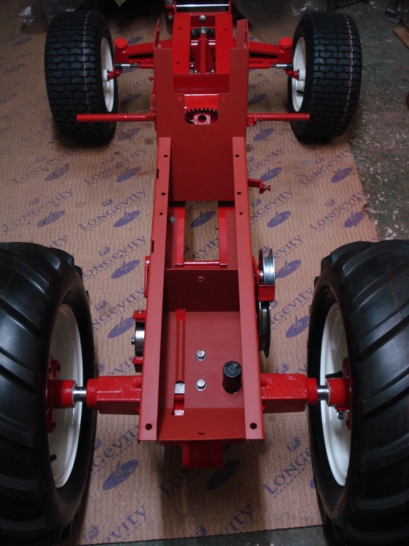

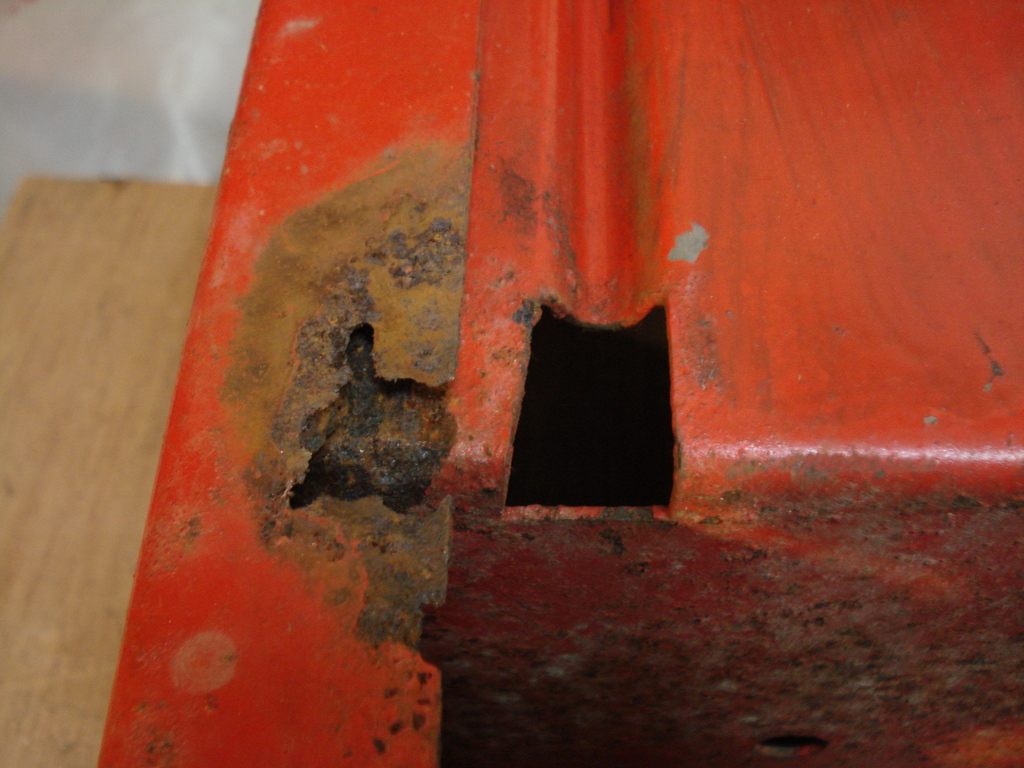

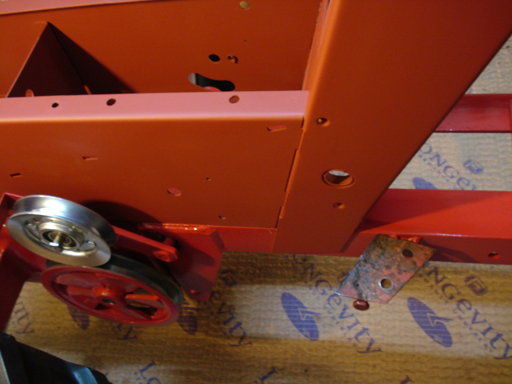

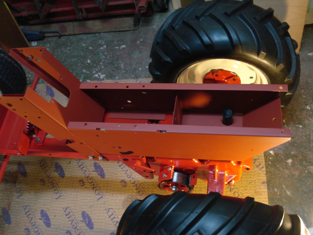

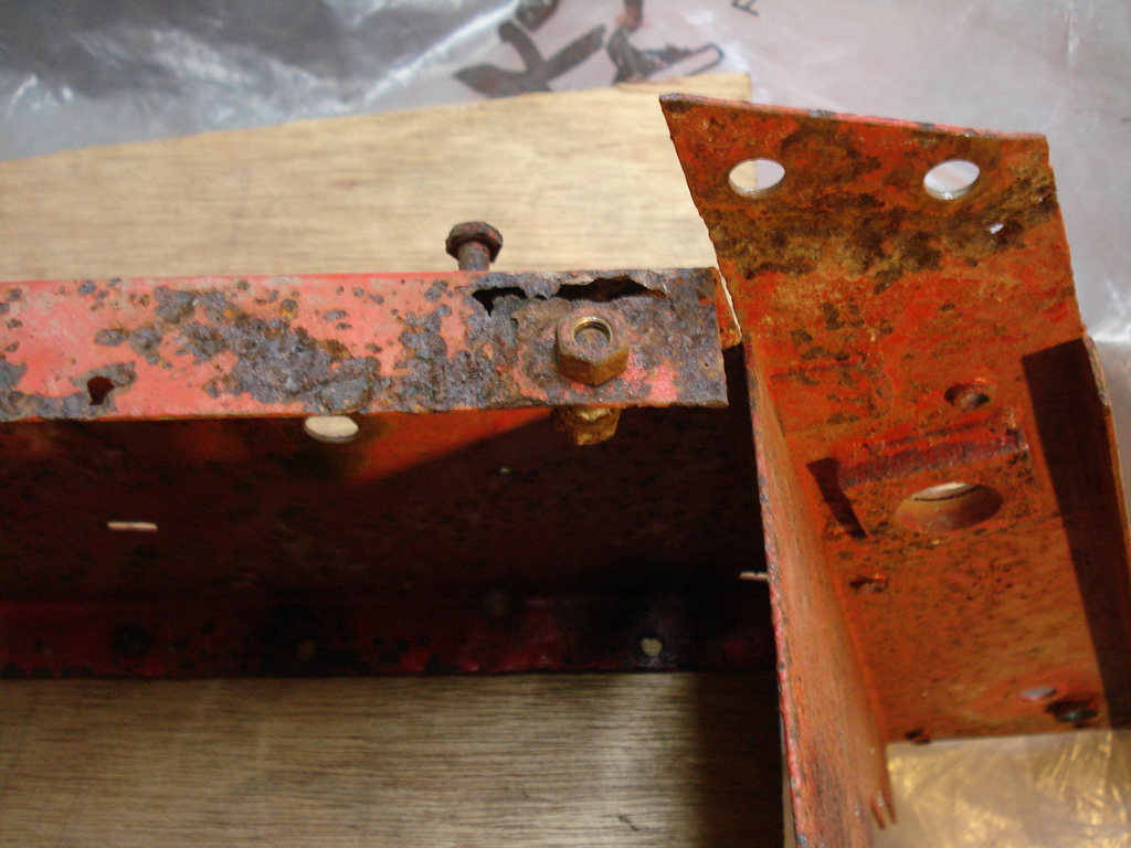

Anglo Traction 761 #26 Posted April 14, 2011 (edited) It's been a while since my last progress report, mainly due to my attentions having to be directed elsewhere. I targeted the Hoodstand, as it required a lot of work to repair and prepare. Both lower plates and one side wing plate that bolt it to the Frame were rotten- Below- This side (Brake Drum side) had not been Spot Welded when Manufactured and the Rust had 'Blown' and swelled the joint. The other side was done and ok- These areas were cut away, cleaned up and rust treated. I obtained the steel the right thickness and made up new pieces and TIG'd them in place. I managed to get it sandblasted while I waited, got it straight back, Zinc sprayed and began filling/blending. Took 2 days to smooth off as nearly every surface was heavily pitted. It's now had the first coat of red primer to highlight any spots I missed and fitted it for 'Spotting Through' for the bolts. I'm adding 2 more fixing points for rigidity, the last 2 holes in the Frame before the Tranny Plate- Old side Wing piece and the new one welded/blended and snug fitting. The Lift Arm Bearing bore has a nylon bush fitted to prevent grit ingestion during blasting- The Tank Support is done as well, but have to re-align one of the side plates when I 'Mock Up' the Hood, Dash Housing and steering. Then it's 'Paint Time' and start on the Brake and Clutch Linkage . That's all for now. Regards. Edited July 19, 2017 by Anglo Traction 1 Share this post Link to post Share on other sites

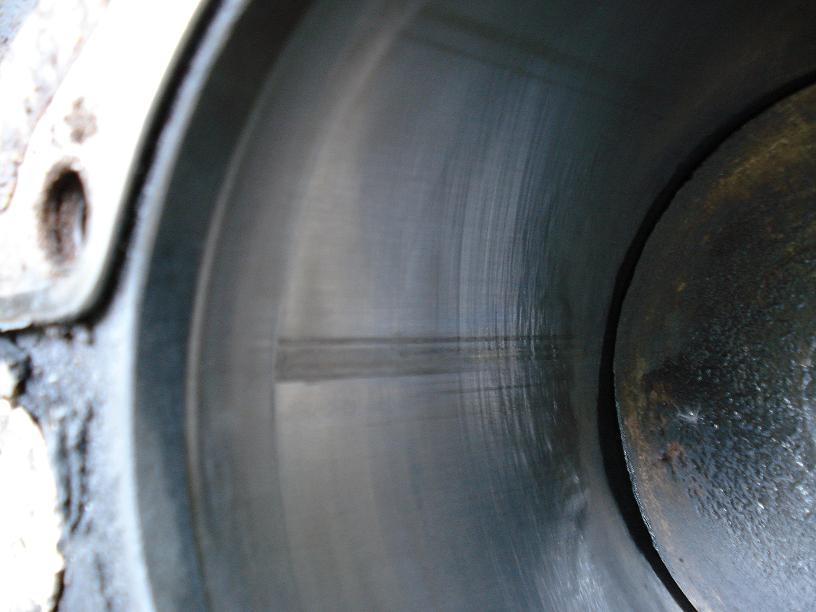

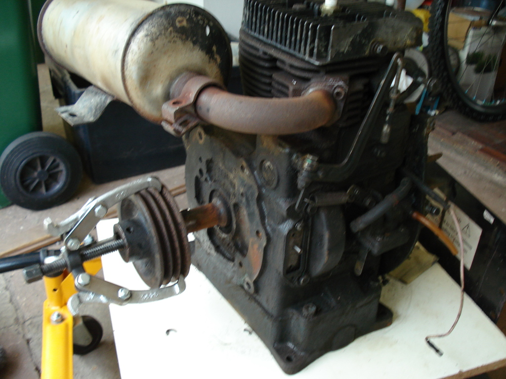

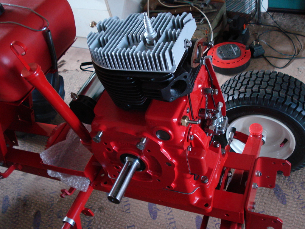

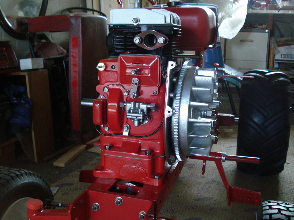

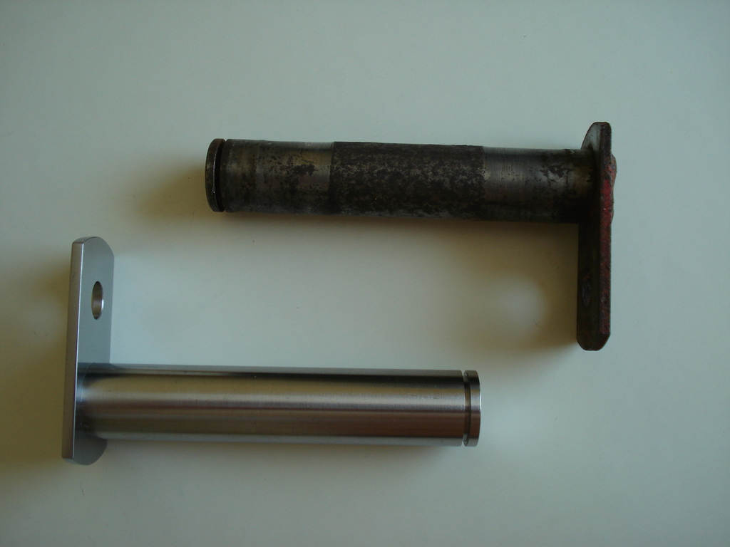

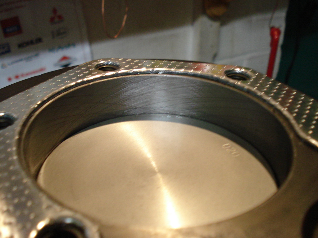

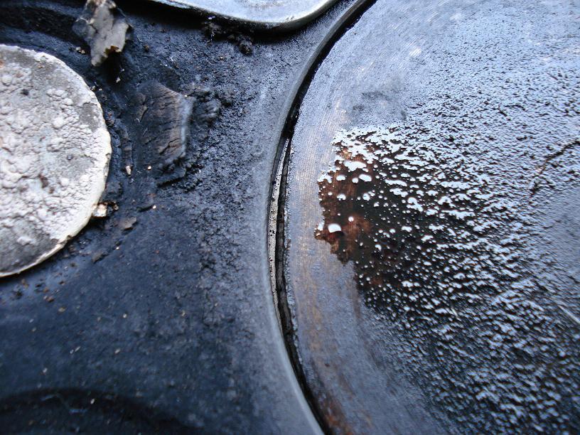

Anglo Traction 761 #38 Posted October 18, 2011 (edited) Mmm !, apart from being 5 months since my last update, I've been trying to log on here for several days without success. So I may have to Post one part at a time. During my absence, I've been battling with the frustrations of sorting a decent Motor for this WH and decided to make something of this 'So Called Superb Condition Engine'- . Scored Bore and damaged Piston all caused by lumps of Carbon breaking off- A complete strip down also revealed a need for a Crank Re-grind, so I set about finding a place to have the work done, sourcing the parts and costing the whole Rebuild. In the meantime, I chipped away at the 'No Cost' jobs like making up a new Axle Pivot Pin- Finally tied down a Machinist (long established family business) in August and ordered the Piston/Rod etc after it had been inspected. Eventually (10 days ago), everything came together and I picked up a nice clean re-bored (0.020") Engine and a shiny re-ground (-0.010") Crank. A few other parts were purchased, as the old ones were borderline in tolerance and started the assembly after throwing some Paint on it- I swapped the Oil Pans over, due to oil drain location and then planted it back onto the Tractor before putting the Flywheel etc on. Took the opportunity to Highlight the Timing Marks and set the Points/Timing- I'll add another post shortly as the Forum link is still dropping out. Edited July 18, 2017 by Anglo Traction Share this post Link to post Share on other sites

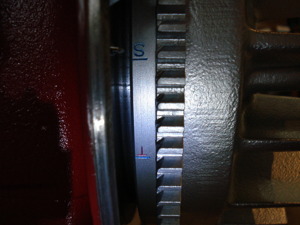

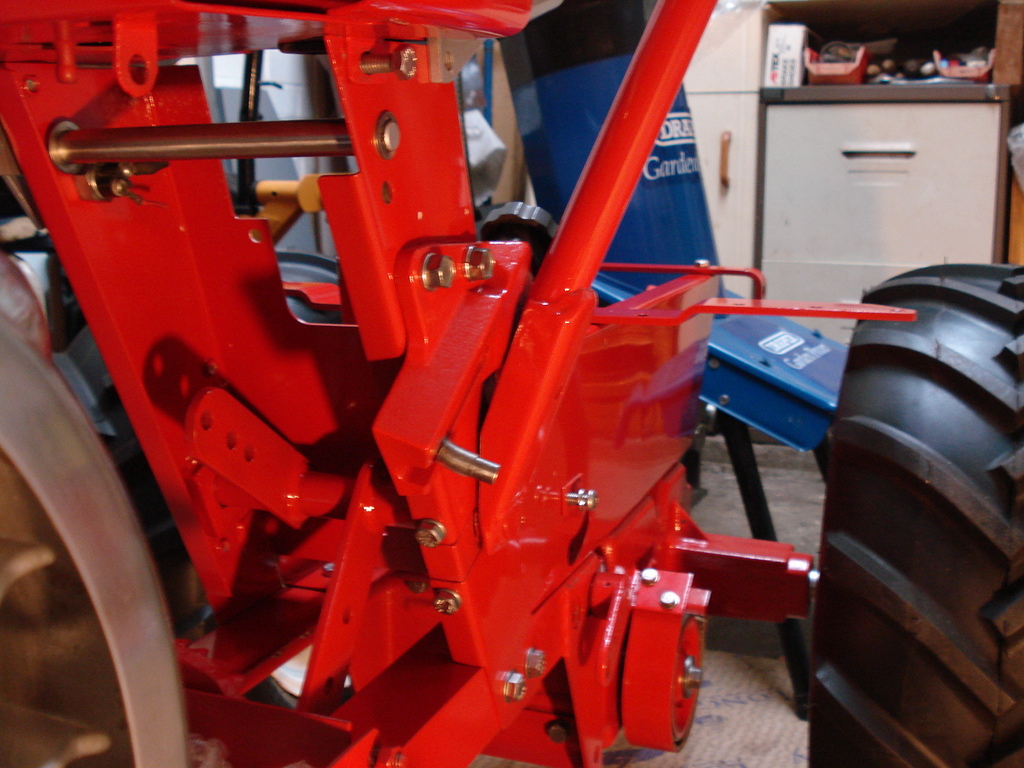

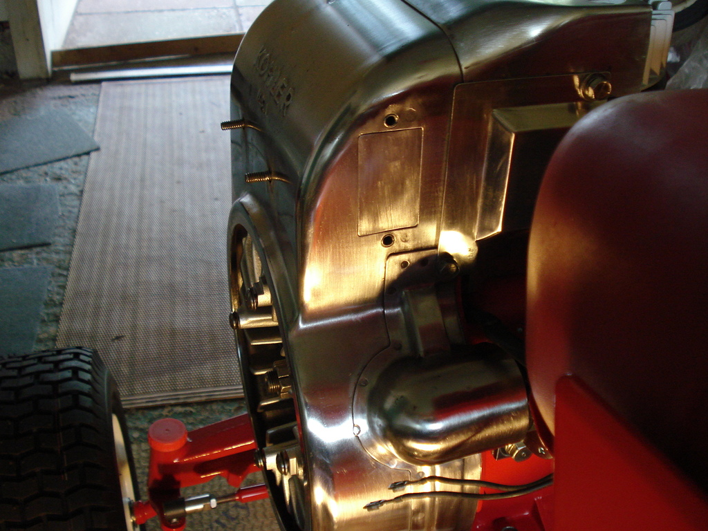

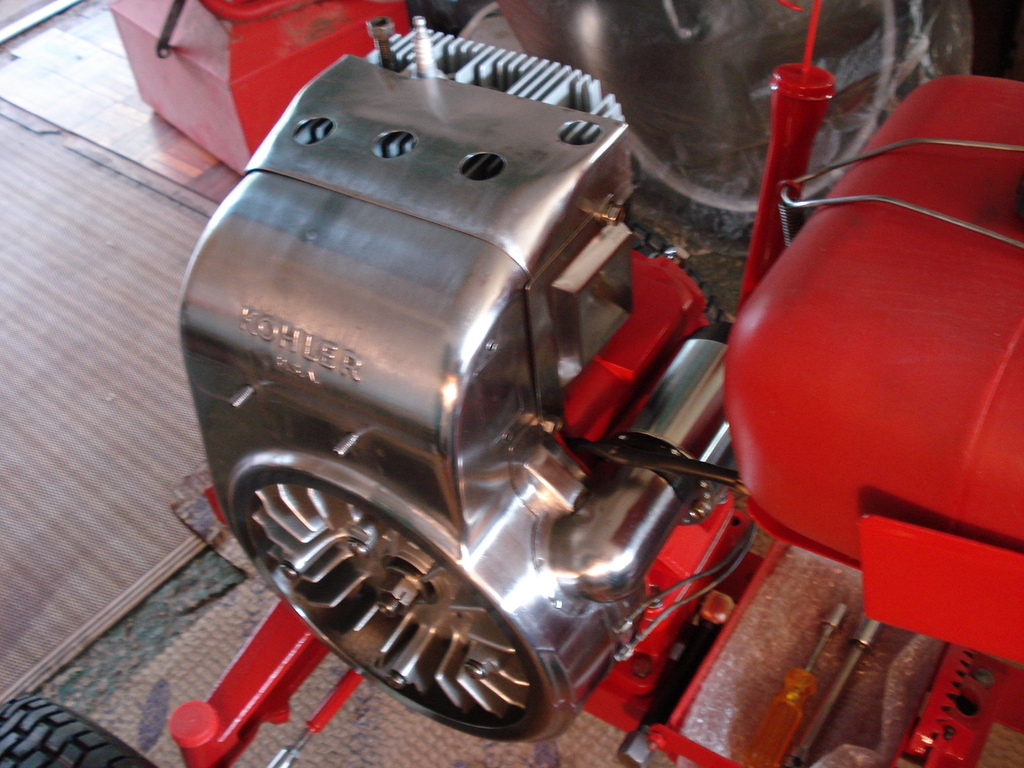

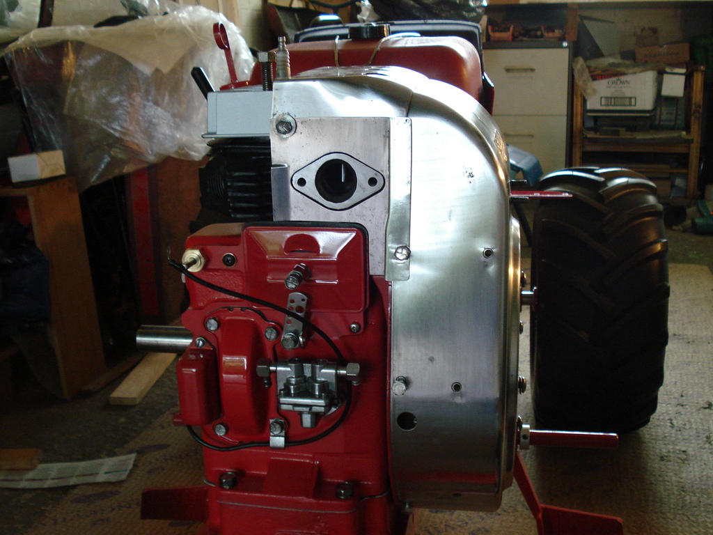

Anglo Traction 761 #39 Posted October 18, 2011 (edited) Ok , next attempt....... Engine mounted- One little mod was the addition of a Stiffening Tube for the PTO Lever Rod which fits between the side panels of the Hoodstand. New Bushings also machined up- Because this Engine is from a diffeent Application, I have several changes to make to the Shrouds, not to mention beating out dents and straightening out some distortion. With them all cleaned off, I mounted them to check the fit etc. Also shows an idea of how it looks if you Chrome plate the Tin !- The changes consist of marking out & drilling the point for the Throttle Cable Pivot on the front of the Shroud. A thickening pad will be added for tapping the Threads . I may have a use for the 2 Studs on the side face above the Flywheel. The other change is to seal up the apperture where the Regulator/Rectifier was fitted. It is where the Solenoid has to go. Also involves drilling, adding thickening pads and Tapping, Welding up (including the old holes) and blending out- Next job is to make a new Wiring Loom, then see if my Sand Blaster Man is available to do the remaining Panels. He was evacuated from his premises for a week due to a serious fire at a Recycling Plant 40 yards away recently. So the next update won't be as overdue as this one. Regards Edited July 18, 2017 by Anglo Traction 1 Share this post Link to post Share on other sites

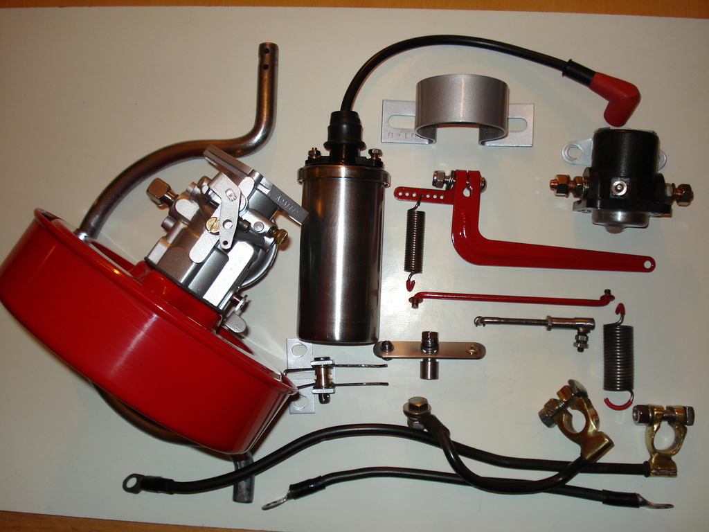

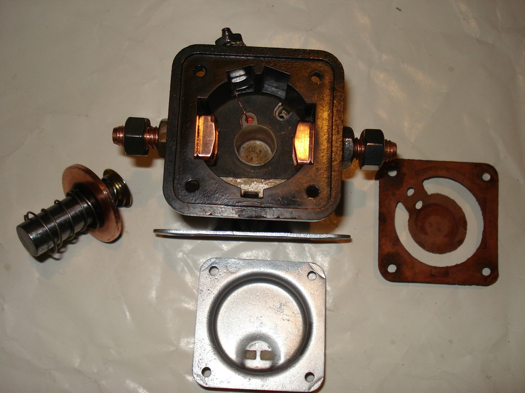

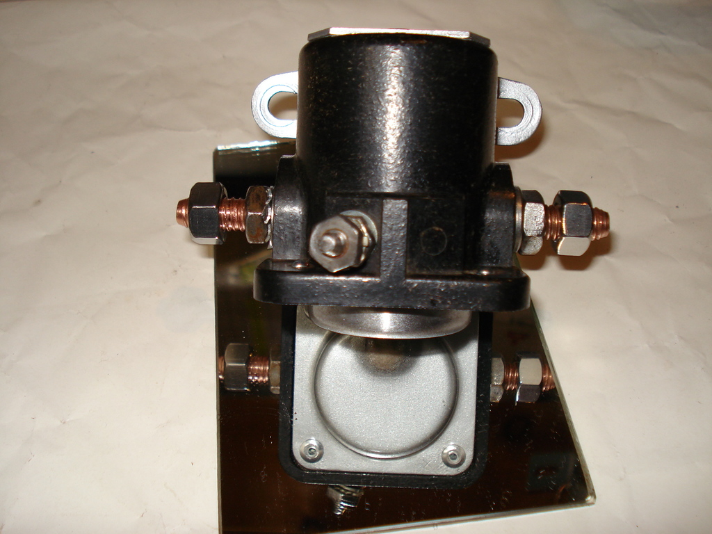

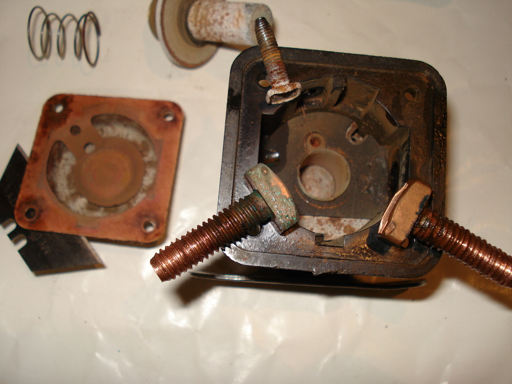

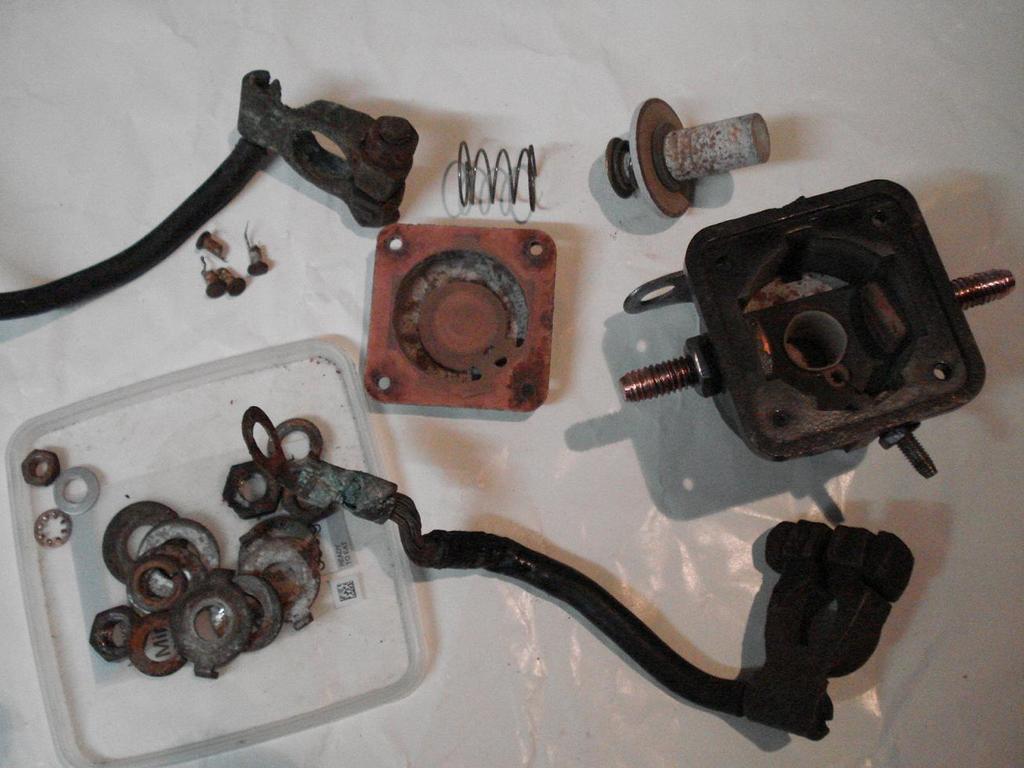

Anglo Traction 761 #46 Posted November 13, 2011 (edited) Stigian said: rmaynard said: I think the engine tins would look great in brushed chrome. I have to agree there though a pair of shades might be needed when servicing the engine Great work as ever Richard Any more updates? Hi Ian/All, Yep!, I agree with Bob's suggestion of Brushed Chrome effect. Problem would be the blemishes and pitting, so I'll be painting it. Not much in the way of progress, except for refurbishing and making a few parts. I've had a week in France and 6 days down in The West Country. I've stripped out and repaired the original Solenoid. A simple job. The PO had chewed up one of the Terminal threads, so I had to sort that (the Washers shown all came off the term'ls). Battery Cables had also suffered at his/their hands- The Contact Flats on the Copper Terminals were crooked, so the Actuator Disc only touched the edges. Lots of Arc Spark residue around the inside and close to Tracking and possibly burning out the Energiser Coil- All cleaned up and ready for another 30 years of use with the Contact positions correctly set- Battery Terminals now bonded to new Leads, made up new Throttle Pivot Linkage, Seat Latch Bushes and Carb fully re built. All the ignition parts are now good and ready to fit- Re-wire cables on order and welding up a few bits and painting this week hopefully. Edited July 18, 2017 by Anglo Traction 1 Share this post Link to post Share on other sites

Stigian 1,235 #48 Posted November 19, 2011 Amazing attention to detail Richard, the carb, coil, air filter etc look better than new.. Are you still interested in buying those 'orse bits from me? Share this post Link to post Share on other sites
