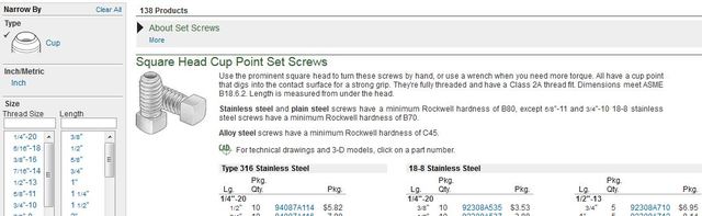

Ed Kennell 44,997 #7 Posted October 16, 2016 1 hour ago, wallfish said: All of the above but if that doesn't work.... Drill and tap a second hole in the hubs, 90 degrees of the original and lock them down with a second set screw. Cheaper, than replacing the hubs. John has the answer. Yes, definitely use the square head cup point set screws with a lock nut. If my hubs do not all ready have the second set screw, I add them. The second set screw keeps more of the hub/shaft surface in contact preventing wobble in both directions. Also, make sure there is not a second set screw already in the hole. It is common practice for some mechanics to stack the set screws. 6 Share this post Link to post Share on other sites

Ed Kennell 44,997 #10 Posted October 22, 2016 (edited) My choice for all high strength fasteners. Edited October 22, 2016 by Ed Kennell 1 Share this post Link to post Share on other sites
JAinVA 4,638 #11 Posted October 22, 2016 (edited) Rob, The suggestion for better setscrews has merit.The factory used a cup point setscrew with a square head.Grade 8s are superior to almost any other fastener but keep in mind that the hubs are cast steel and be careful of the torque you put on the setscrews.The reason I suggested you check the hub fit on the axle is that if the hubs wobble to any great degree it could mean that the bore is not only out of round but in severe cases hourglass shaped.This would only be on a very high time machine but if the case then setscrews will not stop a wobble over time and with load.JAinVA Edited October 22, 2016 by JAinVA 1 Share this post Link to post Share on other sites
