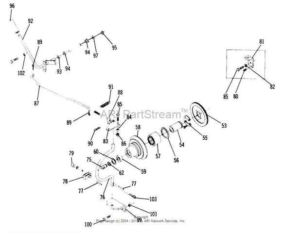

wallfish 20,733 #5 Posted October 16, 2016 Yes, the PTO is basically a clutch but without a description, I assumed you were referring to the transmission. Tension can be adjusted by the trunnion (#89) right above the pulleys. (Assuming the lining on the plate is still intact) You can remove the PTO pulleys to inspect the lining. #53 This isn't the exact drawing for your tractor but those parts are in the same spot 1 Share this post Link to post Share on other sites

wallfish 20,733 #8 Posted October 17, 2016 Sorry, the trunnion is actually #88 Share this post Link to post Share on other sites
