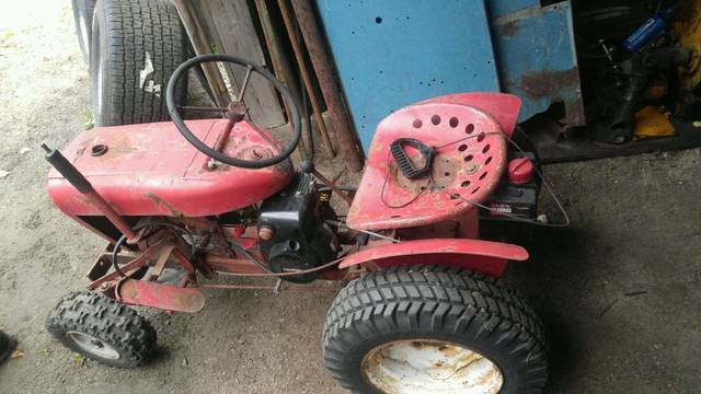

Deadguy 861 #1 Posted October 11, 2016 I have an opportunity on a Suburban series that needs a new lease on life. Any idea which model this one is? 4 Share this post Link to post Share on other sites
T-Mo-(Moderator) 4,599 #2 Posted October 11, 2016 Looks to be a 551 from my limited knowledge as it has the '61 foot rests, a battery hold down bracket and the throttle and choke cables are beside the steering column with the switch on the circular piece below the steering column. Of course it has the wrong engine, but that isn't surprising after 55 years. 2 Share this post Link to post Share on other sites
Mike'sHorseBarn 3,242 #3 Posted October 11, 2016 If I had to guess that would be my take as well. Looks like a 551. Share this post Link to post Share on other sites
Deadguy 861 #4 Posted October 11, 2016 Thanks! I read that the 550 and 551 have different transmissions, with the two piece Unidrive in the 551. Is this the better of the two? Share this post Link to post Share on other sites
wallfish 18,055 #5 Posted October 11, 2016 The 2 piece is a bit beefy'r than the 3 pc. It's a 551 but has a 1960 clutch pedal. Funny the foot rest is mounted upside down on the wrong side. Ask if they have the dozer blade, I see the lift link for one is still connected Share this post Link to post Share on other sites
Deadguy 861 #6 Posted October 11, 2016 If this turns out to be a mashup of a 550 and a 551, and has the 550 transmission, do I still want it? Share this post Link to post Share on other sites

wallfish 18,055 #11 Posted October 11, 2016 (edited) 4 hours ago, Deadguy said: If this turns out to be a mashup of a 550 and a 551, and has the 550 transmission, do I still want it? That's a 2 pc trans on there. The frame would have to get cut to add a 3 pc. to it. When it comes to nut roasters the trans type shouldn't really matter, you're not going to hang a back hoe off it either way. The 3 pc transmissions work perfectly fine for the tractors they're on. It appears to be all 551 except the pedal so if you get it and are going to do a full restore to it, I'll trade pedals so you have the correct one for it. But not interested if you're just going to throw on a preditor engine and go. Might as well just leave it. Edited October 12, 2016 by wallfish Share this post Link to post Share on other sites

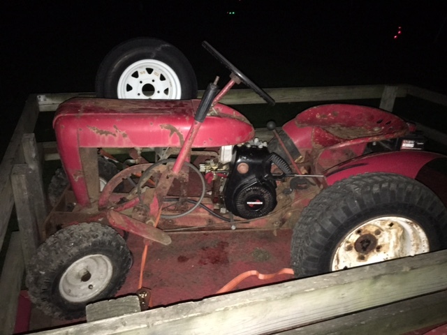

Deadguy 861 #19 Posted October 15, 2016 It turns out the posting was taken down because the seller's wife was thinking about keeping the tractor.... But the guy still wanted to sell it anyway! So I showed up with cash, and this followed me home! 5 Share this post Link to post Share on other sites

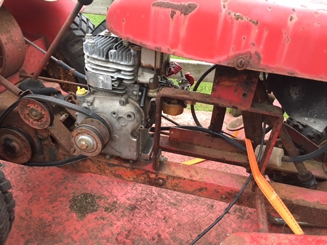

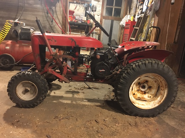

Deadguy 861 #21 Posted October 15, 2016 Here is what we have so far. There are no ID plates on this machine that I have been able to find so far. It definitely has a UniDrive transmission. There is some sort of bumper/weight bracket bolted to the front. The front wheels are 5" diameter and held on with circlips. It also has a slot hitch. It is missing the fuel tank cap and belt guard, and of course the original engine. And, one hub is cracked, as are the rear tires. The seat pan is rusted thin and cracked around the mounting bolt. But, the transmission does shift, and the frame and hood are solid. Anything else of notice here? I would post more photos, but the forum has now limited maximum upload size to .11mb, making photo submission impossible. Share this post Link to post Share on other sites

Achto 29,351 #24 Posted October 15, 2016 6 hours ago, Deadguy said: Here is what we have so far. There are no ID plates on this machine that I have been able to find so far. It definitely has a UniDrive transmission. There is some sort of bumper/weight bracket bolted to the front. The front wheels are 5" diameter and held on with circlips. It also has a slot hitch. It is missing the fuel tank cap and belt guard, and of course the original engine. And, one hub is cracked, as are the rear tires. The seat pan is rusted thin and cracked around the mounting bolt. But, the transmission does shift, and the frame and hood are solid. Anything else of notice here? The only id plate on these was a sticker on the frame with the serial number, probably long gone. The front wheels should be 8" rims held on with cir clips. Fuel caps can be found at most good hardware stores. There are guys on here that make new belt guards and exhaust guards. Finding the correct era Tecumseh might take a bit, should be electric start. Looks like some one did some reinforcing on the frame by the trans mount. You have the correct foot rests, only used in 1961, that's a plus. You have a good start & your not in too bad cash wise, take your time gathering parts and you should have a nice little tractor. Share this post Link to post Share on other sites

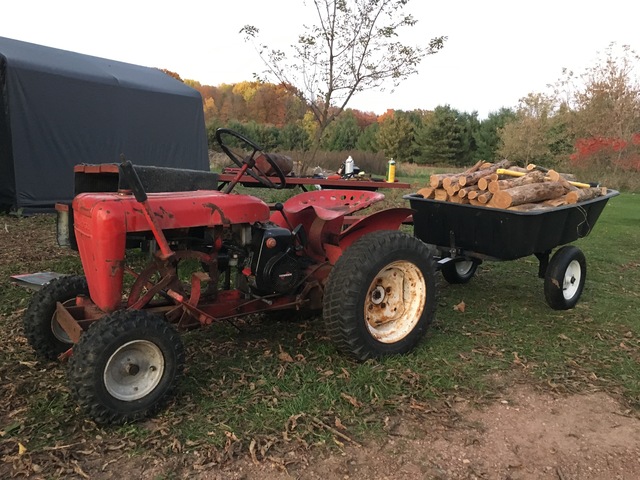

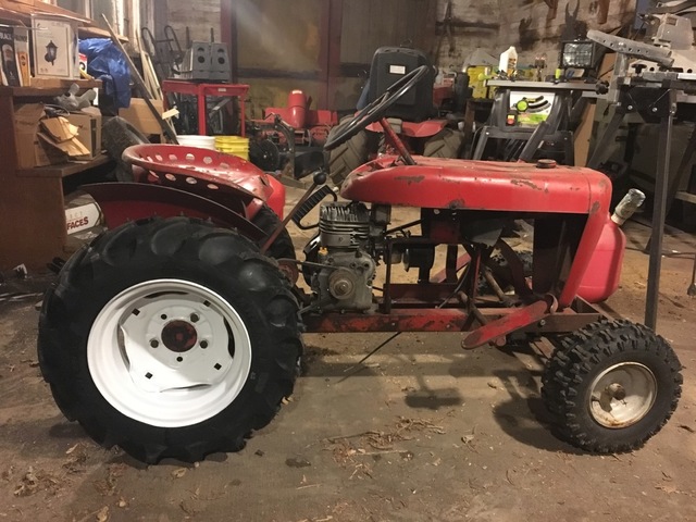

Deadguy 861 #25 Posted November 1, 2016 Time for an update! I have gotten to put the tractor to work doing a little hauling after fitting an air cleaner to the engine and mounting a new fuel tank where it is supposed to be. Today I finished mounting a rear tire after sandblasting and painting the wheel. It is coming along bit by bit! 7 Share this post Link to post Share on other sites
