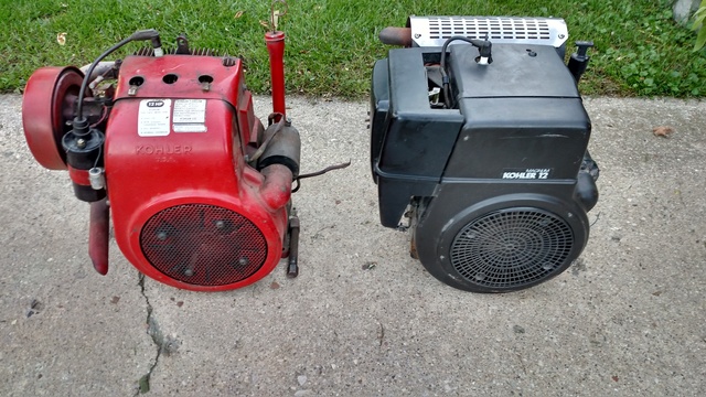

TIGman 2,006 #1 Posted October 9, 2016 Just as I rolled up to the garage with the C-120 my oldest son drove in and snapped a picture. Did get the K301 removed today and ready for the M12 Magnum to go in it's place. A little switch-a-roo while I have the K301 rebuilt. 6 Share this post Link to post Share on other sites

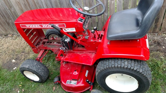

953 nut 69,545 #3 Posted October 10, 2016 As this will be a temporary swap, if you want to save the cost of a new ignition switch you could put a wire nut on the wire that went to the coil and use a cheap toggle switch to ground the magneto to shut it off. Be aware that the PTO/seat switch will not shut it down for you with this set-up. 5 Share this post Link to post Share on other sites
TIGman 2,006 #4 Posted October 10, 2016 15 hours ago, 953 nut said: As this will be a temporary swap, if you want to save the cost of a new ignition switch you could put a wire nut on the wire that went to the coil and use a cheap toggle switch to ground the magneto to shut it off. Be aware that the PTO/seat switch will not shut it down for you with this set-up. For certain I will be asking you 953nut and the other members for help installing the Magnum in the C-120.... I'll have to take a picture after work of the "rats nest" of wires connected to the engine and dash so you can help me sort out the ones I need.... It has me scratching my head right now??? 1 Share this post Link to post Share on other sites
