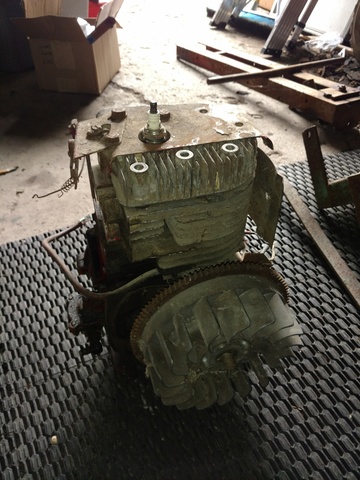

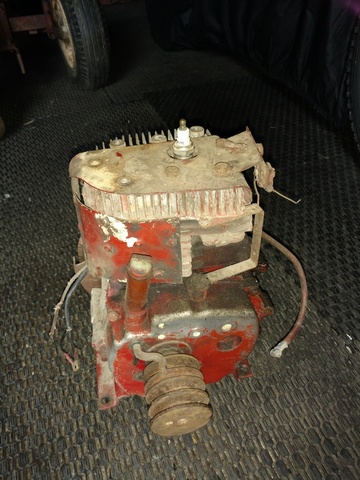

Chris G 3,400 #1 Posted October 9, 2016 Bought this motor with some suburban parts. Not to familiar with these motors. Could anyone help identify if it's a H55 or H60 or whatever model it may be? Share this post Link to post Share on other sites
wallfish 20,733 #2 Posted October 9, 2016 Well it's not an H55 which would have an indent in the crank case for the oil pump right below the shaft.. Looks like an H60 from the pics but probably the best way to verify it is to compare measurements of it to specs from a service manual 1 Share this post Link to post Share on other sites
KC9KAS 4,746 #3 Posted October 9, 2016 The numbers are on the flywheel shroud. Not a tag but the numbers/letters are stamped into the steel from the inside out..Hope this makes sense. 1 Share this post Link to post Share on other sites
