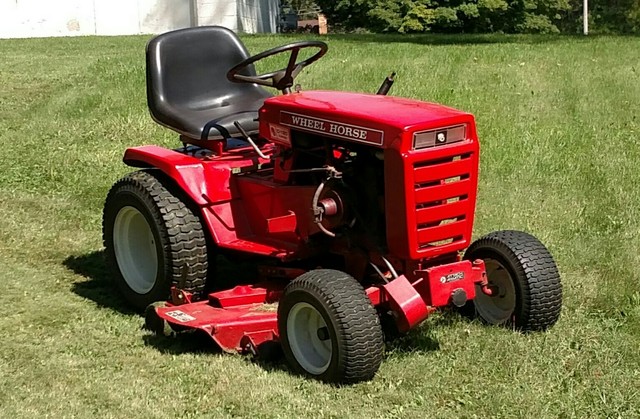

hcminis 1,818 #1 Posted October 6, 2016 This ole girl followed me home last Sunday. Did a little horse trading for it. Drove it on the trailer and off....then went to put it in the garage and wouldn't move. Immediately thought the Hydro went out....but thought that was awful quick. Got it to the garage and lifted the seat pan to notice the right rear hub was almost off axle shaft. Someone replaced the hub but only put 1 set screw (bolt) back in AND didn't put the woodruff key in. So, got it fixed and back together. She runs, drives, and mows really well. Only thing needed now is decals and lights. Oh...new drive belt is on the way as the current one likes to twist inside out. Noticed it has been installed wrong when belt guard was put on. Still a nice Horse. Came with weights, chains, snow plow, and deck. 16 Share this post Link to post Share on other sites
Sparky-(Admin) 26,688 #2 Posted October 6, 2016 Looks good. A set of original looking decals on the sides of the hood would really make it pop! Mike..... 5 Share this post Link to post Share on other sites
TIGman 2,006 #3 Posted October 6, 2016 Great find !!! Sure looks like a nice one you have there. Get your set of decals on to finish her off and maybe we can have a race... 7 Share this post Link to post Share on other sites

TDF5G 2,074 #5 Posted October 7, 2016 Looks like you got a good 'un. I second the motion on the decals! 1 Share this post Link to post Share on other sites
Tankman 3,528 #6 Posted October 7, 2016 Looks great! It is! The Allis-Chalmers is nice too! Decals are a must. Terry does great work, surly the Decal Man! Share this post Link to post Share on other sites
DougC 2,644 #7 Posted October 7, 2016 No key and only jack bolt........ Wonder somebody didn't get hurt! Glad it was a quick and easy fix. Nice looking tractor. Share this post Link to post Share on other sites
Tonyp 285 #8 Posted October 7, 2016 really nice find ! Enjoy it ! Share this post Link to post Share on other sites
