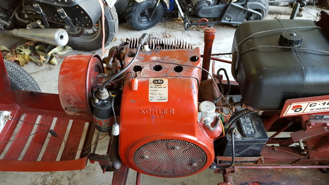

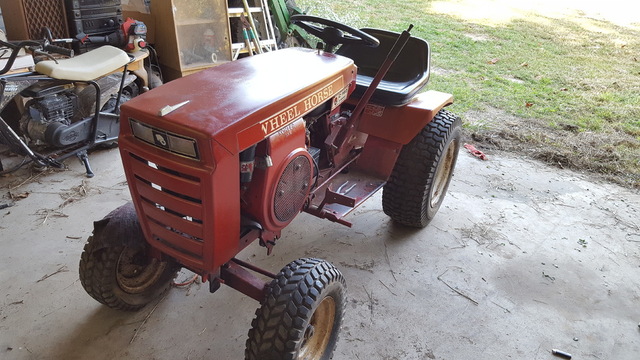

RGStranahan 23 #1 Posted October 6, 2016 So two days ago I saved a c-160 from being crushed at a scrap yard and I know nothing about this thing beside that it runs like a champion!I won't to bring it back to it former glory but don't know where to start I've never even seen one of these till now any advice tip hint and tricks are appreciated. 4 Share this post Link to post Share on other sites

elcamino/wheelhorse 9,363 #6 Posted October 6, 2016 Since you may know the person who decide to scrap the C-160 I won't say much except someone should kick his or her butt. It looks pretty clean and not beat up . Go to the manual section of the forum and you should be able to down load an owners manual , parts list and info on the Kohler motor. Of course ask questions the guys on the forum love to help and they love pictures. Not sure they some of them passed Reading in school By the way O if you have a neighbor that brags about his great mower from the " Box store" hook a chain to his mower and one to yours and see how many times you can pull him around the yard backwards. 4 Share this post Link to post Share on other sites
RGStranahan 23 #7 Posted October 6, 2016 Thank you for the welcome elcamino and the advice all of it lol.I told the guy how...."special" he was for trying to scrap it!I was told it didnt run but lol runs like omg but it smoke a little that a no no right?I was just gonna rebuild it but can't seem to find the rebuild kits. 2 Share this post Link to post Share on other sites
953 nut 70,333 #8 Posted October 6, 2016 This should help you along. 1 hour ago, RGStranahan said: an't seem to find the rebuild kits Take a look at this. http://www.ebay.com/itm/ENGINE-REBUILD-KIT-for-KOHLER-16HP-K341-and-M16-with-an-actual-16hp-rod-not-12hp-/121321472437?hash=item1c3f52c1b5:g:9k8AAOxydlFSzHoJ 2 Share this post Link to post Share on other sites

JackC 619 #13 Posted October 6, 2016 Yours looks to be in good condition. A little lipstick and polish on that horse will go a long way. After I saw this picture, I decided I needed to add one to my collection and I did: The C-160 with the coveted big block Kohler is one of the finest. Imagine someone throwing this away. 9 Share this post Link to post Share on other sites
BOB ELLISON 2,983 #14 Posted October 6, 2016 Yours looks like a new one compared to the one I first got. I love my c160 auto but the 8 speed is a great tractor also. My b80 has a 8 speed same as yours and it will pull or push a tank. The first thing I did was read every thing here about the c160 and kohler k341 before I took it down to the frame. I Cleaned and painted every thing. Changed engine oil and trans fluid and if it's been out in the weather clean gas tank fuel lines and carburetor bowl. If trans fluid is milky then water has gotten in by way of shifter boot ,change it to.i got a boot for $10.00 on ebay. If you want to learn about your c160 these guys here at Red Squrare are here to help you and they really know there stuff. I know I'm also a student. 2 Share this post Link to post Share on other sites

roadapples 6,987 #19 Posted October 7, 2016 Not many better than the C160 IMHO...Great save, and you can`t beat the price.. Before you rebuild it clean the breather below the carb. If it gets gummed up it will cause it to smoke, and 2 Share this post Link to post Share on other sites
