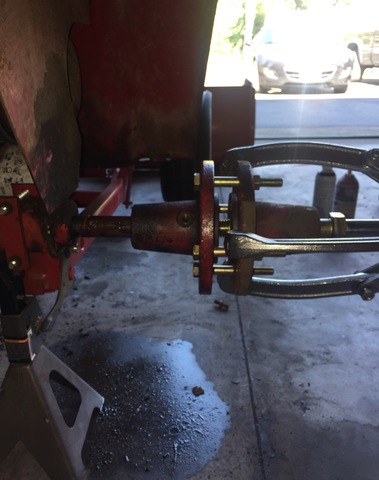

Aldon 4,834 #3 Posted October 6, 2016 Came home for lunch and decided to add some pressure to this rig while I was here. Viola! It may not be obvious but this hub is now broken free and has mover at least a couple inches. I'll free it completely later after work. This is the closest I have come to this hydraulic puller not working. Took approximately two full days of soaking with multiple products. First I tried "In-Force", then "Kroil" and lastly "PB Blaster" For hubs, PB Blaster ha proven most affective for me. u 6 Share this post Link to post Share on other sites
ztnoo 2,302 #4 Posted October 6, 2016 Congrats Aldon!!! Thought you were trying to break my record for "Longest Duration GT 14 Hub Pull". They can be one of the most frustrating chores associated with these tractors. My right side was also the worst to deal with. Looks like you have the bulk of the job done now. 2 Share this post Link to post Share on other sites
WHX?? 58,323 #5 Posted October 6, 2016 3 hours ago, Aldon said: that can damage the bearings. Not to mention knocking off that circlip inside ...then you do have work!! 1 hour ago, Aldon said: soaking with multiple products. Ahhh and you best go git some kitty litter Aldon ... looks of it you got half of it on the floor! 2 Share this post Link to post Share on other sites
Aldon 4,834 #6 Posted October 6, 2016 Definitely a HAZMAT superfund site in the making! 5 Share this post Link to post Share on other sites
