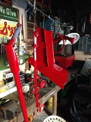

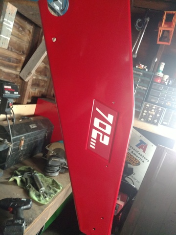

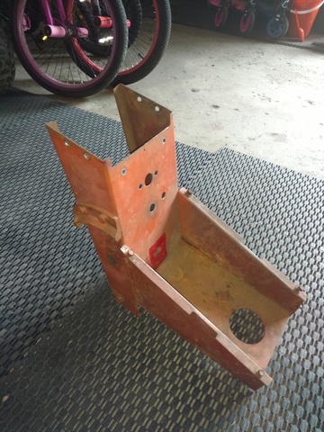

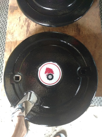

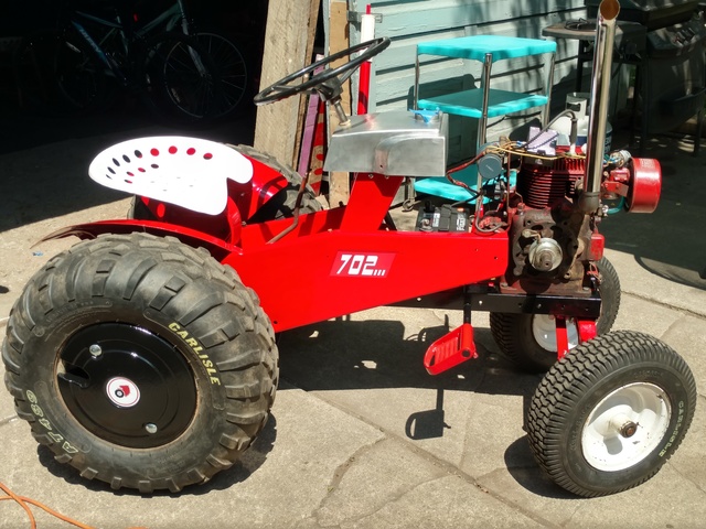

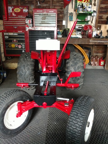

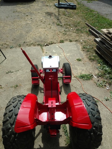

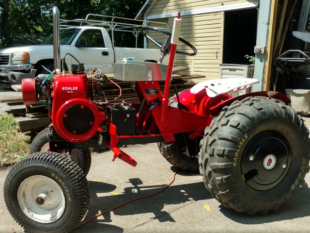

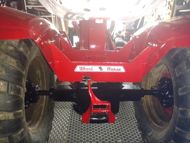

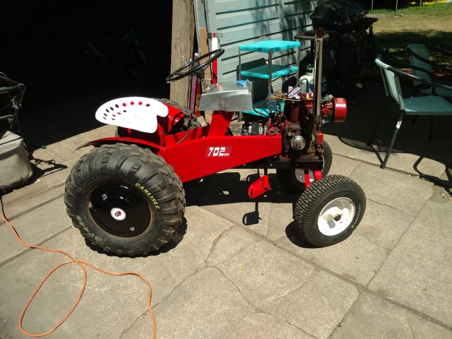

Chris G 3,352 #1 Posted October 5, 2016 I realized I never posted this project. It's a bunch off odd parts i had picked up to save from junk and so on. So I figured I would build me another tractor. Its a 702 tower,steering components, fuel tank, frame, fenders and tool box. The motor is a 8hp Kohler off a 8hp 4 speed. Belt guard and front axle came off a lawn Ranger. The rear end I got in a package deal. The guy said it came off a 1971 workhorse 800. The hood I picked up was in two pieces when I got it. Which works cause I got to extend it 3 1/4 inches. So I won't feel guilty of hacking up a good hood. I got different tires for the front and the rear tires are 25x11-12 atv tires. The weights were just random 55lbs weights I had. So they got painted and dressed with a Wheel Horse decal. I had to move the motor ahead 1 1/2 inches. Then added a belt tensioner. But all is coming together well. It's gonna be my new plow tractor. The engine just got basic attention. She ran good so I left her be. I still got to finish placing some electrical and make a exhaust bracket for support. Basically a few odds and ends left to do. I'll post more pics when I get her all buttoned up. But let me know what ya think. 14 Share this post Link to post Share on other sites

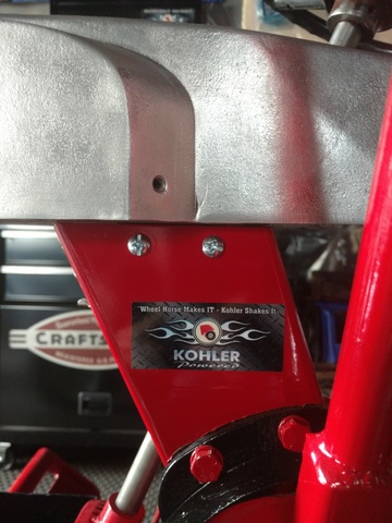

WHX?? 51,696 #2 Posted October 5, 2016 Love it ...that rear rubber is the bomb!!! , Amazing what a guy can do with just parts! I also like the black frame rails ala @JPWH if your not careful gonna be too nice for a plow tractor! Almost forgot to ask about the tank... paint or bare aluminum? 3 Share this post Link to post Share on other sites
Chris G 3,352 #3 Posted October 5, 2016 Thanks! The tank is Bare aluminum. I stripped it and then sanded it 3 different times and now just got to polish it. And ya I used the atv tires cause they run on such a low psi that with the weight I have never needed chains in the past. They just flex and grip. 4 Share this post Link to post Share on other sites
WHX?? 51,696 #4 Posted October 5, 2016 That's what I thought on the tank .... its looks cool. Aren't you afraid it's gonna oxidize?? Maybe a clear coat? 2 Share this post Link to post Share on other sites
Chris G 3,352 #5 Posted October 5, 2016 (edited) I am just gonna use the same polish I use on the rigs fuel tanks and rims. It seems to hold up to all weather pretty well. But If it does start to show anything I will probably clear it then. Edited October 5, 2016 by Chris G 3 Share this post Link to post Share on other sites

Kegler 68 #8 Posted October 6, 2016 Nice toy! Have that same set of rears on my 417H, they are a beast! Wish I had your W/W's to go with them. 1 Share this post Link to post Share on other sites
RedRanger 1,469 #9 Posted October 6, 2016 On 10/5/2016 at 3:56 PM, Chris G said: I realized I never posted this project. It's a bunch off odd parts i had picked up to save from junk and so on. So I figured I would build me another tractor. Its a 702 tower,steering components, fuel tank, frame, fenders and tool box. The motor is a 8hp Kohler off a 8hp 4 speed. Belt guard and front axle came off a lawn Ranger. The rear end I got in a package deal. The guy said it came off a 1971 workhorse 800. The hood I picked up was in two pieces when I got it. Which works cause I got to extend it 3 1/4 inches. So I won't feel guilty of hacking up a good hood. I got different tires for the front and the rear tires are 25x11-12 atv tires. The weights were just random 55lbs weights I had. So they got painted and dressed with a Wheel Horse decal. I had to move the motor ahead 1 1/2 inches. Then added a belt tensioner. But all is coming together well. It's gonna be my new plow tractor. The engine just got basic attention. She ran good so I left her be. I still got to finish placing some electrical and make a exhaust bracket for support. Basically a few odds and ends left to do. I'll post more pics when I get her all buttoned up. But let me know what ya think. On 10/5/2016 at 3:56 PM, Chris G said: Why are those axles so Looooong? And what are those hubs from? 1 Share this post Link to post Share on other sites
Chris G 3,352 #10 Posted October 6, 2016 I'm not sure why the axles are so long. That's the way the rear end was when I acquired it and the hub's were some odd hubs I had laying around. If I remember correctly they came off of a mid 60s sears suburban 6 speed. 4 Share this post Link to post Share on other sites

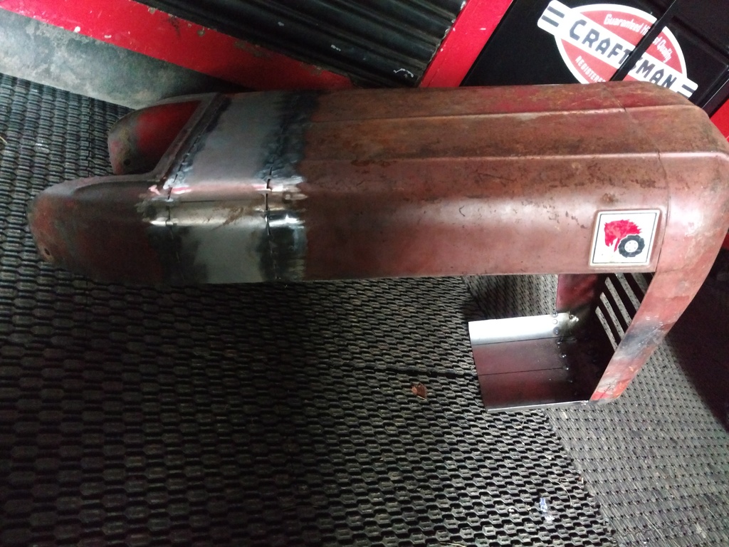

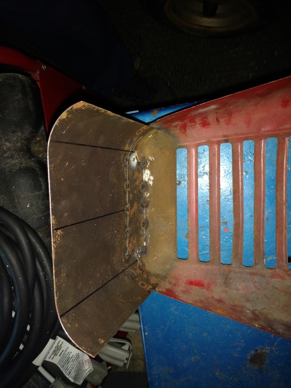

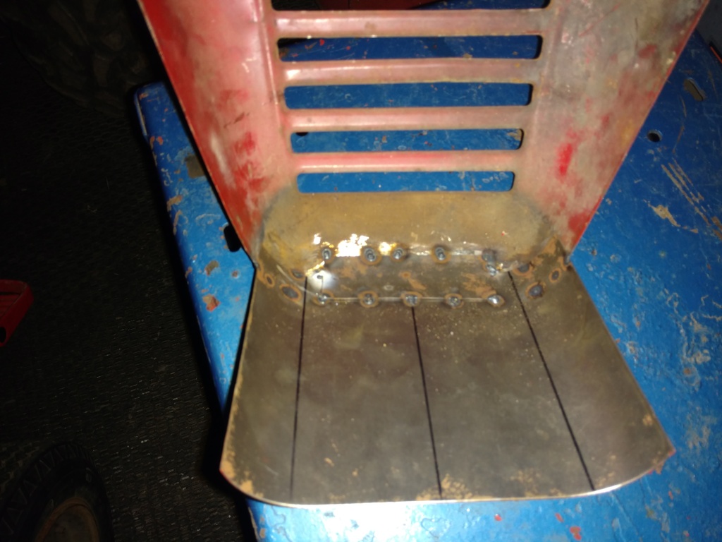

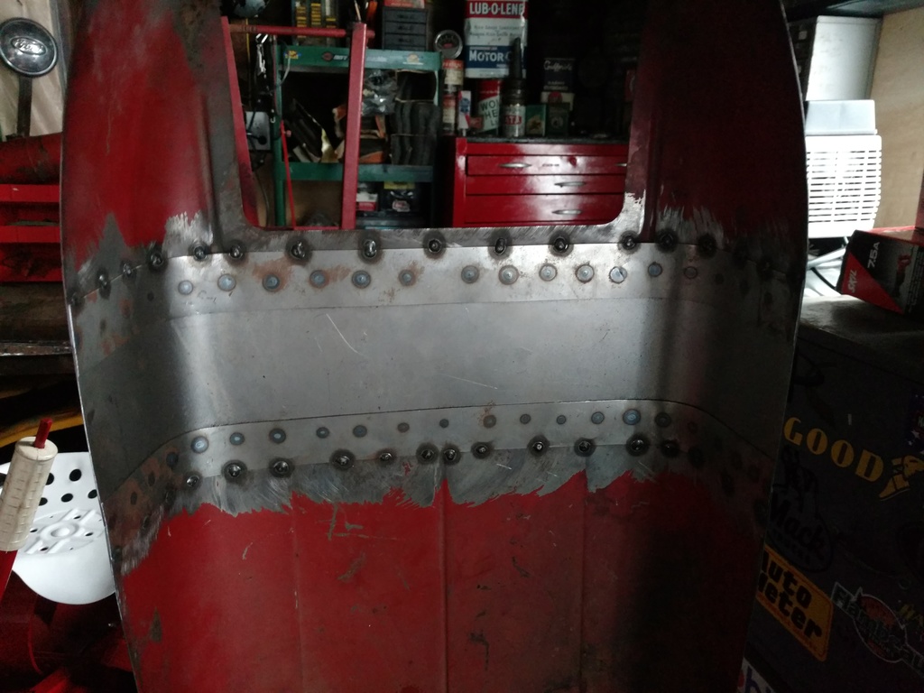

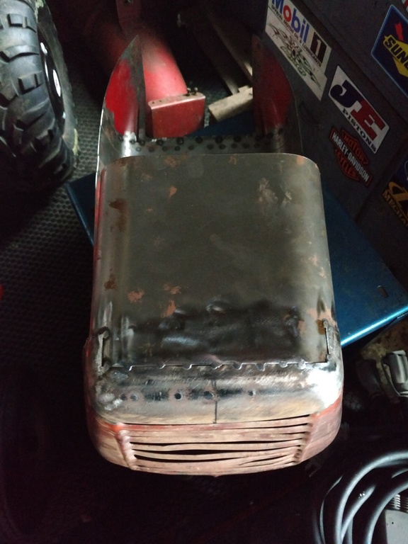

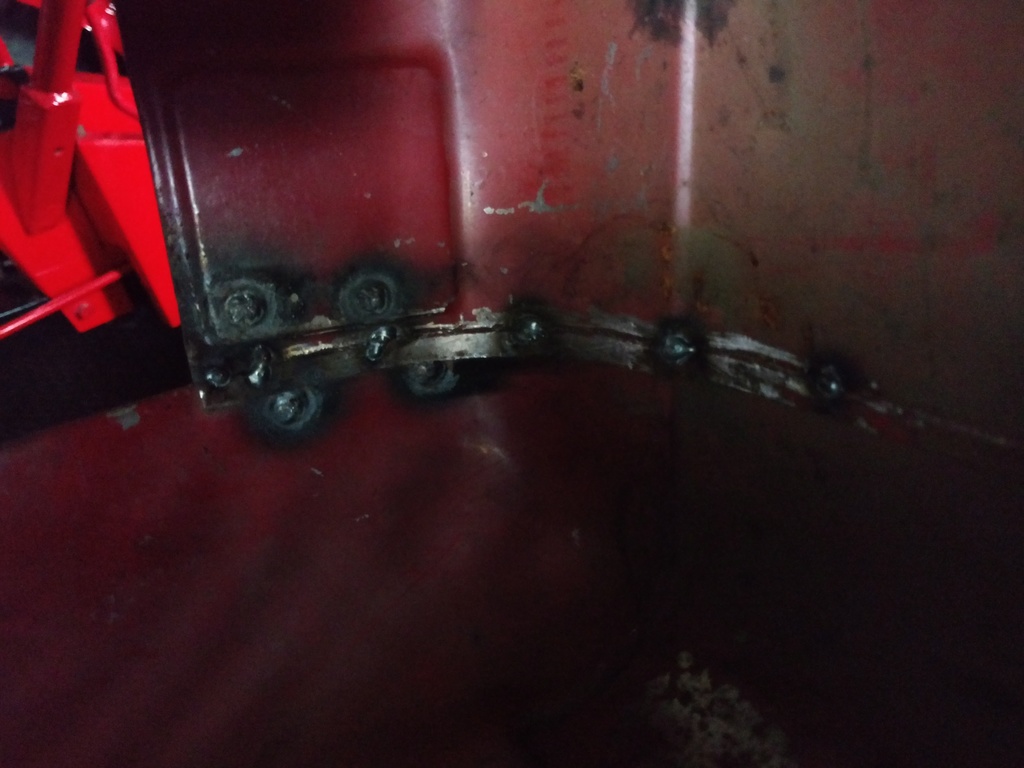

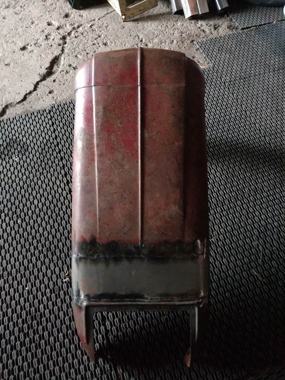

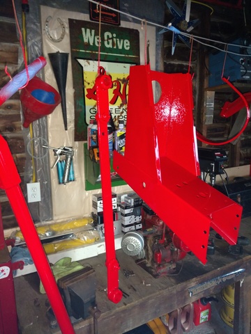

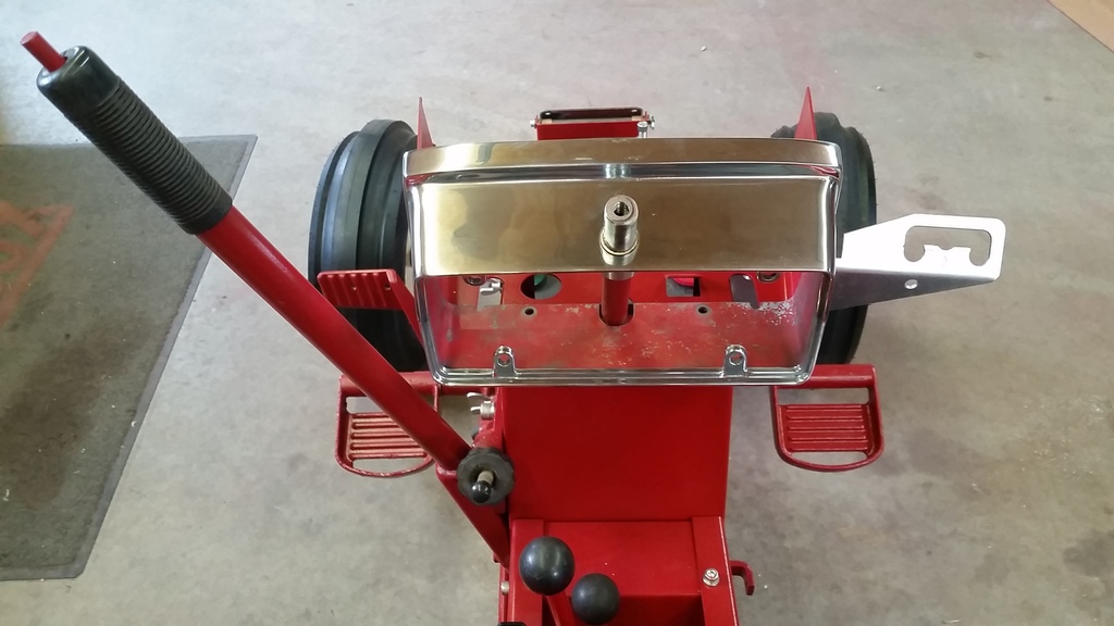

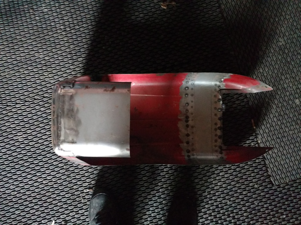

Chris G 3,352 #11 Posted April 7, 2017 Well a little update for you guys. I got back to working on this Horse again. Got the hood fab done all except the bottom hood bracket. But here's some pics. Also this hood was rotted out on the bottom and split along the front seem and someone put a cut in the hood were it raps up to the fuel tank. So I did not chop up a good hood. Just slightly altered it to fit my needs. 5 Share this post Link to post Share on other sites

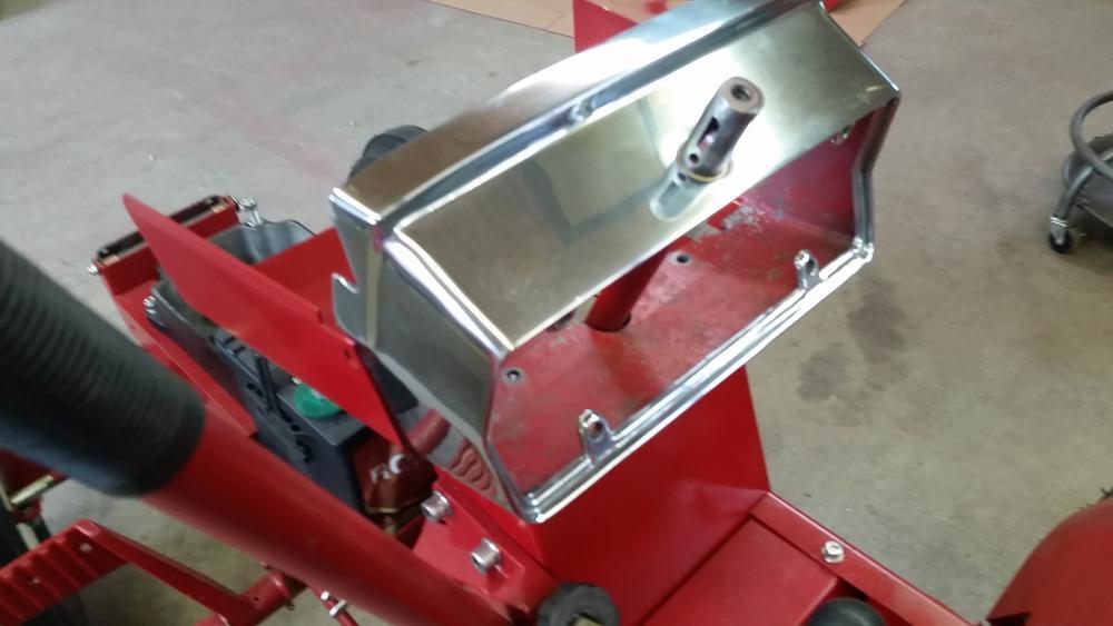

WHX?? 51,696 #13 Posted April 8, 2017 Nice work Chris...looks like you take your time on projects like me! See here what you started tho..... More pics on my 1067 thread once I get off my a$$ and have time to keep making things happen! 4 Share this post Link to post Share on other sites
Chris G 3,352 #14 Posted April 8, 2017 That looks awesome, I'd say your doing a good job yourself! 1 Share this post Link to post Share on other sites
WHX?? 51,696 #15 Posted April 8, 2017 Thanks Chris... I also saw it on another tractor done in a sort of brushed AL style and thought it set off the whole tractor so thought I'd give it a shot. I am in the process of clear coating it but that might have been a mistake kinda lost it's luster but was afraid of oxidation that happened on some of the HD parts I did like this. What had happened I think is the Missus would run her salted car in the garage right next to polished scoots and just that was enough to start the uglyness ....stay tuned. 3 Share this post Link to post Share on other sites
