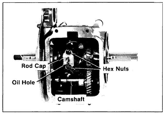

rmaynard 17,101 #5 Posted October 5, 2016 If you removed the rod cap, be sure to put it back on with the oil hole facing the cam shaft, otherwise you will not get proper lubrication and you will definitely lose that rod. 1 Share this post Link to post Share on other sites

C-101plowerpower 1,606 #7 Posted October 5, 2016 2 hours ago, rmaynard said: If you removed the rod cap, be sure to put it back on with the oil hole facing the cam shaft, otherwise you will not get proper lubrication and you will definitely lose that rod. that might well be what is causing the noise, uncle and me replaced the rodcaps the wrong way round in his tractor and it made one hell of a racket, once turned around it was like it just left the factory 1 Share this post Link to post Share on other sites
