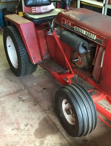

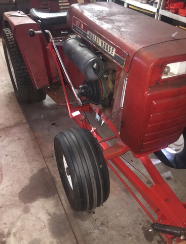

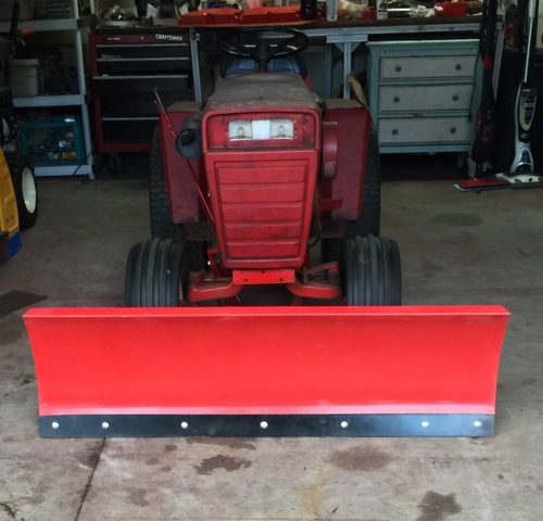

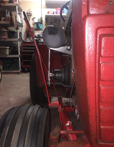

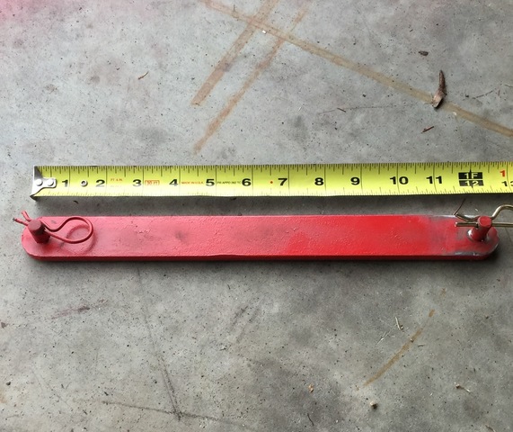

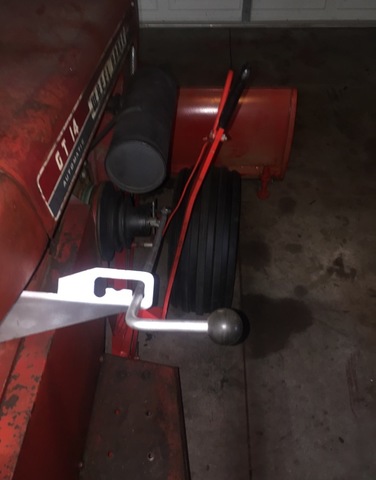

Aldon 4,834 #1 Posted October 3, 2016 Now it won't snow much this year! Got my 54 inch snow blade installed. It fit on the GT14 I parted out but I needed to modify the back ends and take off some of the protruding weld build up to get it to seat properly in the attach-a-matic rear bracket. Also, I had this sitting around for over a year and had thought the bar in pic below went to another implement but got educated out in Indiana this past weekend. Ended up modifying it a bit as well. This allows one to put downward pressure. At least with GT14. Note the slight lift of front end as viewed from the side. i will need to have a lift handle fabbed up longer term as the side style new muffler is potential issue. Also interferes with PTO and PTO control rod but I have removed until I get around to modifying new blade handle. 3 Share this post Link to post Share on other sites

oldredrider 2,554 #4 Posted October 3, 2016 Aldon, if you flip that handle around so the bend is toward the outside, you should have no clearance issues. 2 Share this post Link to post Share on other sites
Aldon 4,834 #5 Posted October 3, 2016 15 minutes ago, ztnoo said: Geezzz, you're ready for snow, and we're still mowing here. The luxury I can afford as I have multiple GT14's running great. This kills multiple birds as well as now I don't have to trip over or physically move the blade. 1 minute ago, oldredrider said: Aldon, if you flip that handle around so the bend is toward the outside, you should have no clearance issues. I think your correct and I may do that in next few days. I'll have to drill a hole for the blade pin pulling lever as it is not centered. I initially was going to install it that way but today I was impatient and when I realized that lever bracket would not fit I decided I would do that later. I'll still likely eventually have a handle fabbed up so that I can clear the PTO assembly and leave it in place during winter. Actually I might have enough clearance for PTO if I flip it and bend it slightly towards the outside. May tackle that in next couple hours. 2 Share this post Link to post Share on other sites

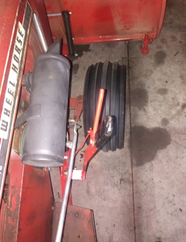

Aldon 4,834 #6 Posted October 3, 2016 While I still prefer making a new control handle which would bring the handle more rearward, I did as suggested and reversed the handle and with some controlled leverage i.e. bending, it now clears the muffler and PTO assembly. As I had postulated I did need to drill a new hole parallel to the original so I could swing the pin control lever bracket to the reverse side. All in all, it would work this way indefinitely. 5 Share this post Link to post Share on other sites
