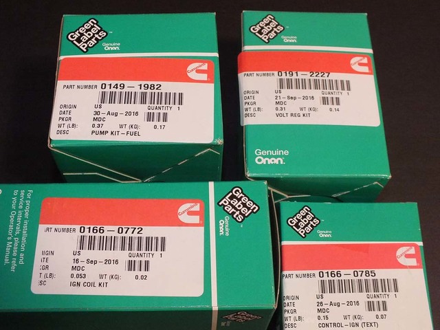

onanparts.com 185 #14 Posted October 4, 2016 On 10/3/2016 at 5:02 AM, JERSEYHAWG / Glenn said: ,,, it's tough getting parts. And until it's apart, it's unknown. Glenn Strongly disagree on the "It's tough getting parts" statement. Agree 100% on the "And until it's apart, it's unknown". Now that bit about it's tough getting parts? Locally that could be very true. Online however there are many sources for Onan parts. They say a picture is worth a thousand words? OK, here is a pic along with a few words...:) A 166-0785 Electronic ignition module, used from 1986-2004. Packaged on August 26th 2016. A 149-1982 fuel pump used from the late 70's up to the late 90's. Packaged on August 30th 2016. A 166-0772 coil used on breaker point ignitions from the early 70's through the mid 80's. Packaged on September 16th 2016, and a 191-2227 voltage regulator used from the 1970's through 2004. Packaged on September 21st 2016, barely 2 weeks ago. Onan stopped making engines back in 2004, but they never stopped making spare parts. The Onan engines were engineered and designed to be rebuildable and to last for many many years offering dependable service. Almost any small engine made today is "disposable" as it's not cost effective to make it last and or be rebuildable. :( If you want to be happy for a day, Drink! If you want to be happy for a year, Repower. If you want to be happy for a lifetime, Rebuild/Overhaul an Onan! 3 Share this post Link to post Share on other sites
