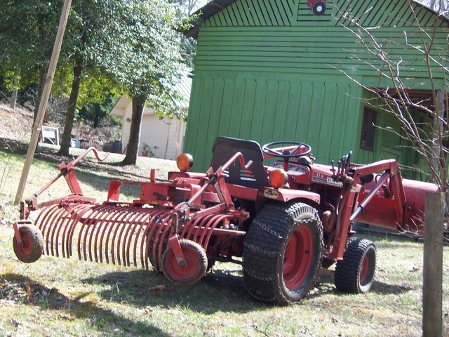

953 nut 70,331 #4 Posted October 1, 2016 56 minutes ago, WheelHorseNut said: I have always wanted a GT14 Well there you go, answered your own question. I have been real pleased with my GT-14 and it works well with a loader. The three point hitch is nice to have too. 11 Share this post Link to post Share on other sites

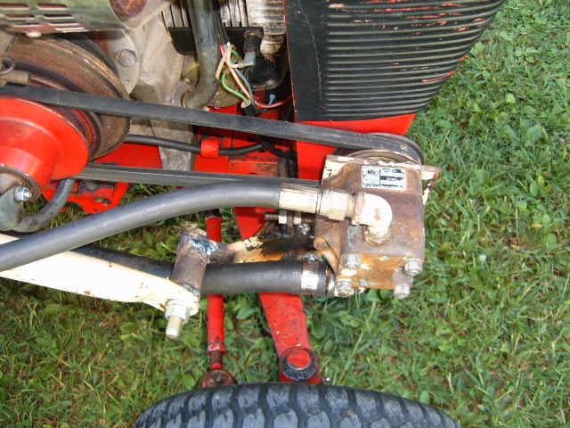

wallfish 20,733 #8 Posted October 1, 2016 1 hour ago, WheelHorseNut said: Basically has to have the hydraulic option. Any thoughts? The loaders are run from a separate hydraulic pump powered from the PTO of the engine and do not use the trans hydraulics. So no need to limit yourself to a hydro trans tractor. GT-14s are nice bigger style tractors and that loader looks good on 953's tractor. 2 Share this post Link to post Share on other sites
