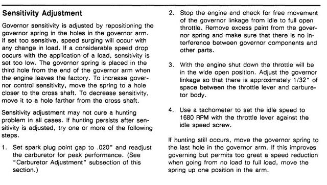

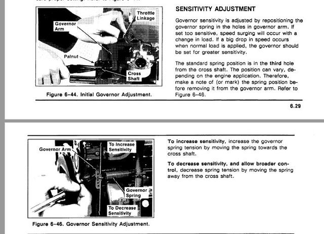

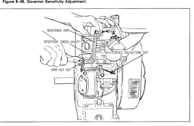

pfrederi 20,249 #2 Posted October 1, 2016 (edited) Last hole in the throttle 5th in Governor Edited October 1, 2016 by pfrederi Share this post Link to post Share on other sites
clueless 3,384 #3 Posted October 1, 2016 Thanks, I have those instructions they are for the big block. The ones I have only have the two holes in the top of the governor arm. Also when you say the last hole in the throttle there are three which do you consider the last hole? Share this post Link to post Share on other sites

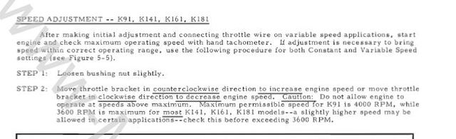

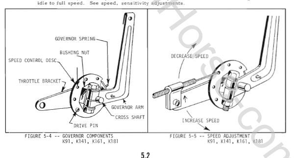

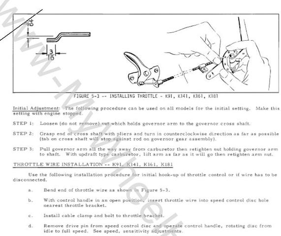

pfrederi 20,249 #4 Posted October 1, 2016 small block Share this post Link to post Share on other sites
