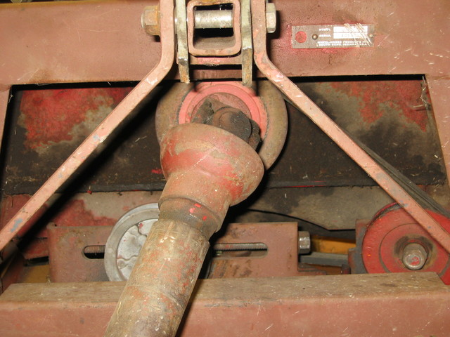

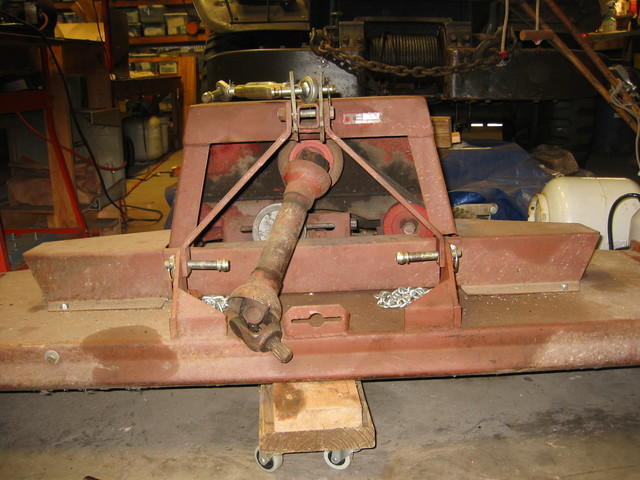

pfrederi 20,625 #2 Posted October 1, 2016 (edited) Not only speed but direction of rotation is an issue. Also the spline count the PTO shaft. I have the 5ft WH (but made Woods) made finish mower for my D200. I assume the C195 uses a high speed PTO like the D...if so you would have to change out pulleys and the belt to get appropriate blade speed. The pulleys you would need would be smaller than what is on there so it should fit under the shroud ..but it would be a search to get the right pulleys. and there is the direction of rotation issue. Farmall cubs and some others have PTO shaft that turn opposite the normal, Woods made decks to fit both directions I can't tell what the one in the picture was for. Edit: These are shots of my 60" The cover on the top may or may not look shorter than on the one you showed. Note the size of the top pulley on the PTO shaft. i would bet the one for sale has a much bigger pulley. I wold also wager all teh other pulleys are eth sam siz so if you could get a top pulley you might be in business make sure to check rotation Edited October 1, 2016 by pfrederi 2 Share this post Link to post Share on other sites
