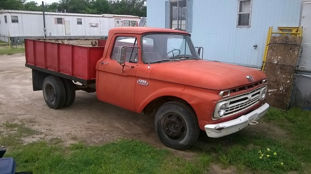

jrandyg 44 #16 Posted October 5, 2016 From the pics, very little if any rust. Owner says no rust. 4.1 inline 6 with TH350 trans. If I feel like hotrodding it a bit in the future I can always throw a small block at it. Trans would work without needing replacement. Paint is faded but i've studied and studied the pics. I can't find any rust bubbles at all. I did notice the cowl isn't mating up with the hood and windshield like it should though. I watch all the weekend TV car shows and I'm always a little nervous about whatever the last guy may have done to the vehicle. I'm thinking that as i've aged and mellowed so has my driving. I can baby it for a while until I gain confidence in its reliability. Randy Here's a thought.... Wheel Horse shop truck. I have to keep it blue but I'd welcome any logo designs for the doors. Anyone...? I'm thinking a faded or weathered look. Share this post Link to post Share on other sites
