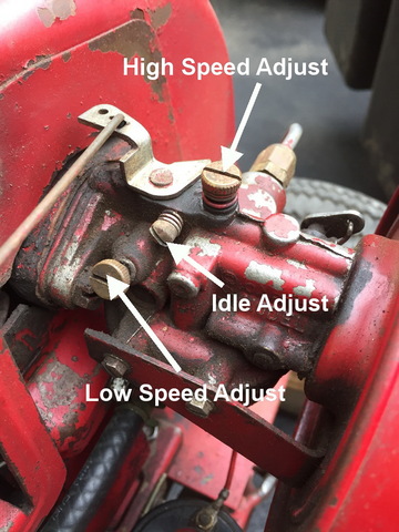

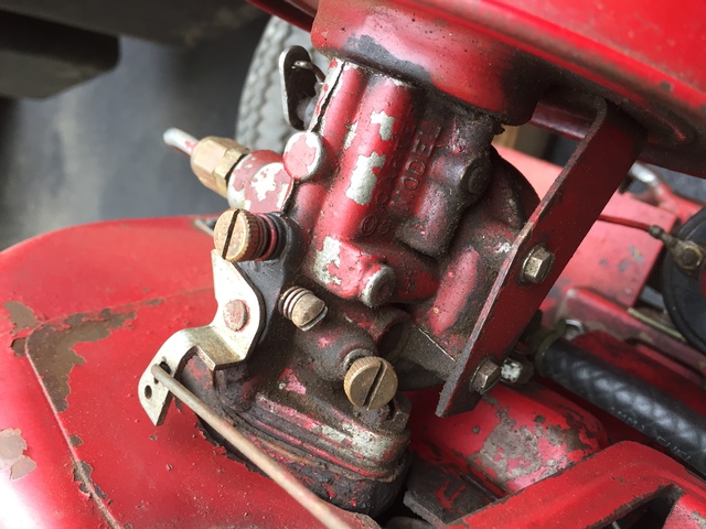

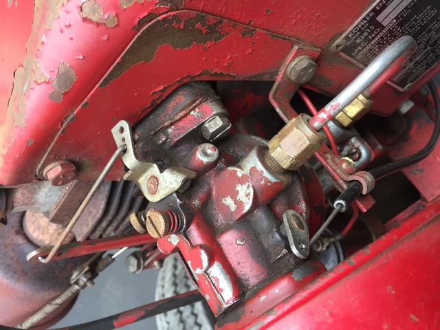

1967 857 28 #1 Posted September 30, 2016 Hi Gents! I own a 1967 857 with an 8 HP Kohler and a Carter carburetor. Engine runs with the choke knob pulled all the way out and when it is pushed in, the engine stops running. Read through several posts and then, using Red Square (a terrific resource by the way!), I downloaded and read the Kohler Engine Owner's manual for a K181S engine (the 8 HP) but its guidance appears to reference the Walbro and not the Carter. Looking for direction on how to best remedy the situation I describe above and properly, correctly, adjust the carburetor screws for a Carter carb. Thank you! Share this post Link to post Share on other sites
rmaynard 17,583 #2 Posted September 30, 2016 Turn both adjustment screws clockwise until they just bottom out. Then open them the number of turns described in the manual. Fine tune them by turning clockwise until the engine sputters, then open counter-clockwise until the same thing happens. Then find the halfway point in-between. 2 Share this post Link to post Share on other sites
1967 857 28 #3 Posted September 30, 2016 Thank you Bob - as there are three screws, which two are you referencing (top screw, middle screw or the bottom screw)? Share this post Link to post Share on other sites
rmaynard 17,583 #4 Posted September 30, 2016 The two flat top screws are the adjustments described above. The round head screw is for setting idle speed. 3 Share this post Link to post Share on other sites
