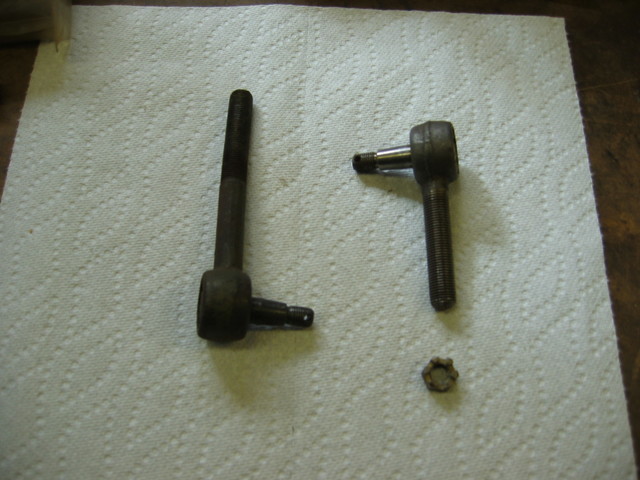

pfrederi 21,306 #2 Posted September 30, 2016 Sarge (as Sarge you may appreciate this) The only cross over between my Military Vehicle hobby and my wheel horse addiction is that one of the tie rod ends for a M274 is a perfect match for the D series (which side i have to go look and it is raining out). 1 Share this post Link to post Share on other sites

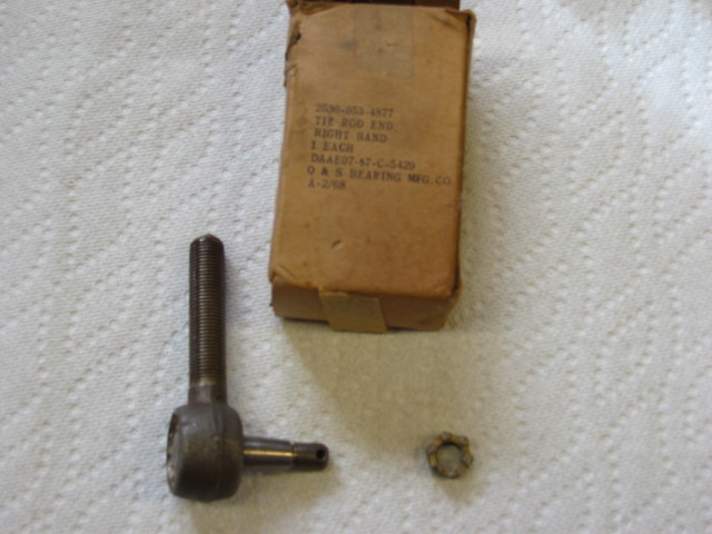

pfrederi 21,306 #5 Posted October 1, 2016 Right side mule is 2530-953-4877 they are (or at least were) not to hard to find. You can see the left side one has an extended shank and is hard to find. The right side has 3/8 Nf threads on the ball joint and 1/2 NF (right handed) on the shank If you search a popular auction site for " M274 MULE TIE ROD END (SHORT) " you will find one. 1 Share this post Link to post Share on other sites

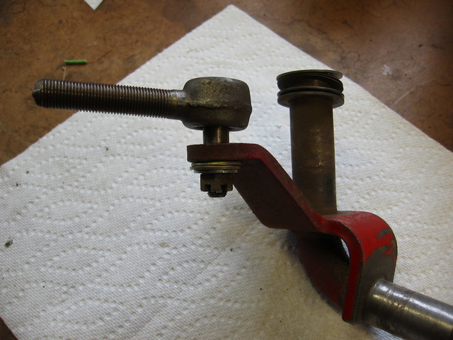

pfrederi 21,306 #6 Posted October 1, 2016 You will need a couple washers. The arm on the Mule is thicker than the spindle arm on the WH I mocked this up with a 1" D200 spindle I had. i think you can get rubber boots if you really want them, Army didn't use them Share this post Link to post Share on other sites

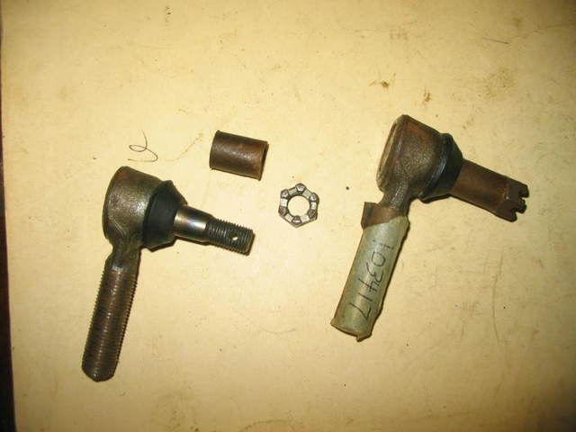

Sarge 3,473 #7 Posted October 2, 2016 Excellent info , sir . Keeps me from using the USMC approach to fix it ....lol . I'm bidding on one short version now , there is also a set of long/short/adapter on Ebay currently . I'll do some more research , at least now I know where to look . Just a side note - I noticed Joe's Outdoor Power has listed a 1"-3/4" reducer as an axle part - is that for a later model wheel or steering spindle ?? Thinking about either boring the axle and making bronze oilite bushings for it or finding a 1" axle setup with wheels to boot down the road . This one has some wear , not too bad yet but I work stuff pretty hard . Sarge Share this post Link to post Share on other sites

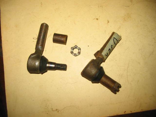

pfrederi 21,306 #8 Posted October 2, 2016 The adapter one in the picture wouldn't work for you. With the adapter it would be too long . (Wish they had these a few years ago when I paid bigger bucks for a long end for my Mule). I didn't find the "axle reducer so I can't comment. 1" spindles are a good thing. Several threads here about coming up with better hub bearings for 1" axles. Share this post Link to post Share on other sites
