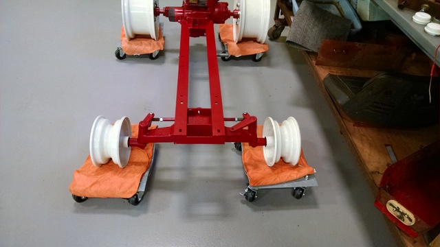

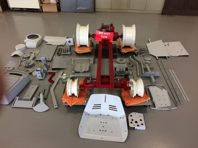

p38js 444 #13 Posted September 29, 2016 Glenn, I can not offer you any pros and cons to paint vs powder coat yet. However here is what I have done so far to my GT14. I have had the frame, wheels and steering components powder coated the red is RAL3003 and the wheels are an appliance white that the powder coated had in stock. They were sandblasted and coated in zinic for corrosion protection. The rest of the parts were sandblasted and painted with PPG JP209 high build epoxy primer to fill damage from corrosion. Let the sanding begin. They will then be shot with a nice coat of PPG RAL3003 single stage paint. The transmission was stripped cleaned and primered with zinic cromate primer then coated with RAL3003 red from a rattle can. So far I have $300 in to the powder coating $50 in the PPG primer and about $200 in zinic cromate primer and misc. sanding supplies. 6 Share this post Link to post Share on other sites
