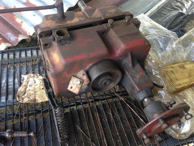

Dnorth 6 #1 Posted September 28, 2016 I am new to this group, I have a Wheelhorse 10 8 speed. trying to fix hi/low gear and replace gaskets. Got it about inch apart but cannot get it to come apart the rest of the way. Any tips? Share this post Link to post Share on other sites
ACman 7,673 #2 Posted September 28, 2016 (edited) to @stevasaurus I'll let you handle this one . I think that you need to remove the hub , and brake drum . Though I haven't had any of these apart myself . Edited September 28, 2016 by ACman 3 Share this post Link to post Share on other sites
stevasaurus 23,455 #3 Posted September 28, 2016 (edited) That is correct...take off the hub and brake drum and then lift off the left side (brake drum side). Here is the manual...you need Section III. Place the right side of the transmission down. We also have some threads showing how to do this in the Reference Section under Transmissions. 492-4004.pdf (application/pdf Object) I am not sure where you got that 10360 number from. Your transmission looks like a 10 pinion Limited Slip #5060. Even though your transmission has 8 speeds (6 forward and 2 reverse)...that particular transmission is called a 6 Speed. Check out this thread. Edited October 7, 2016 by stevasaurus 3 Share this post Link to post Share on other sites

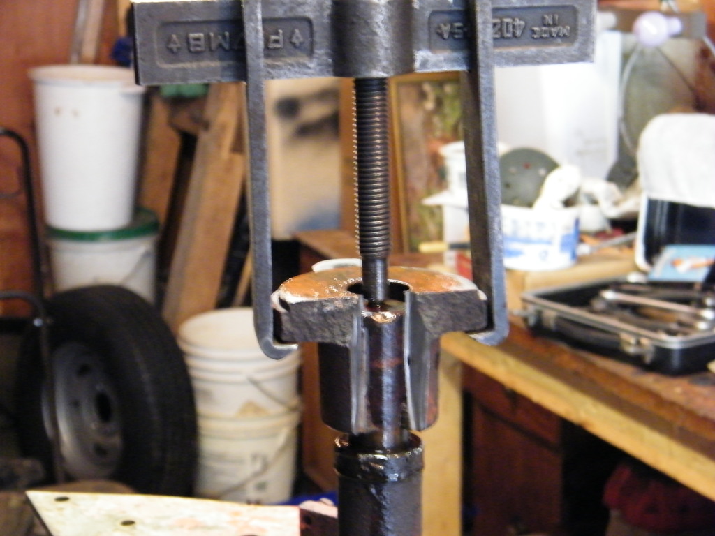

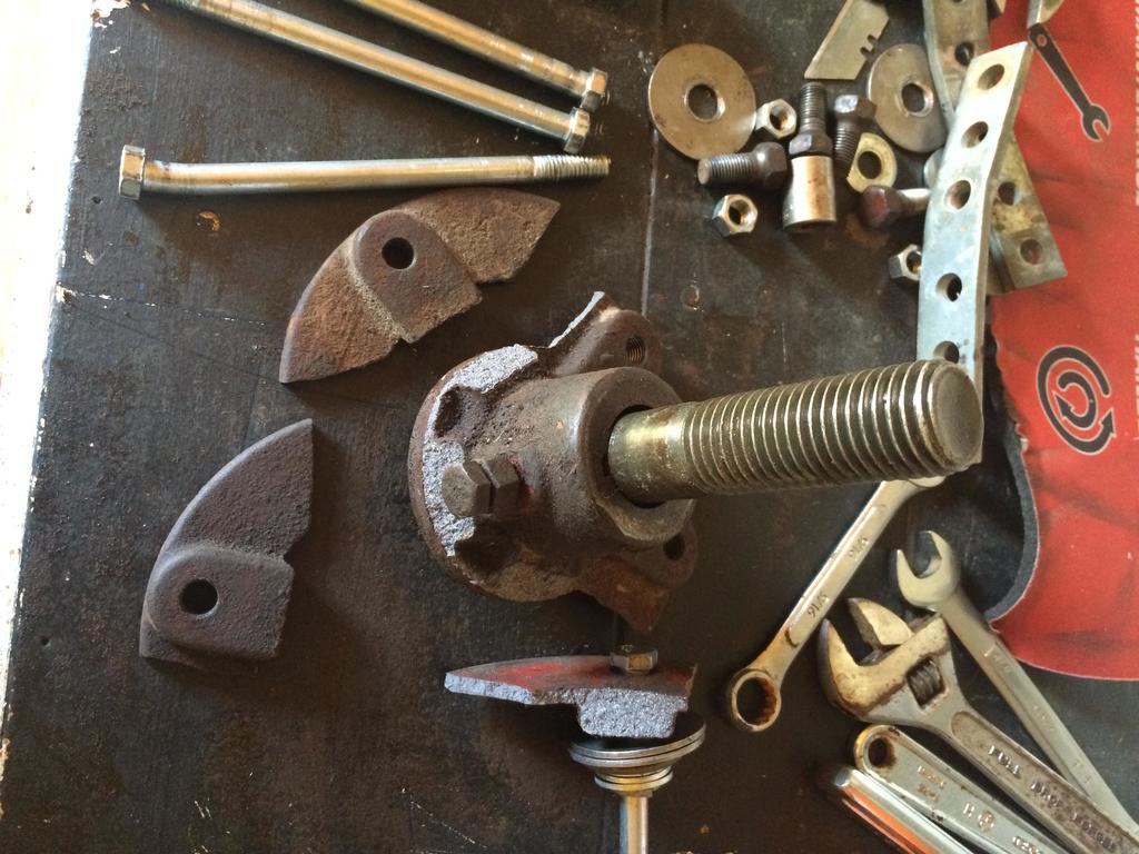

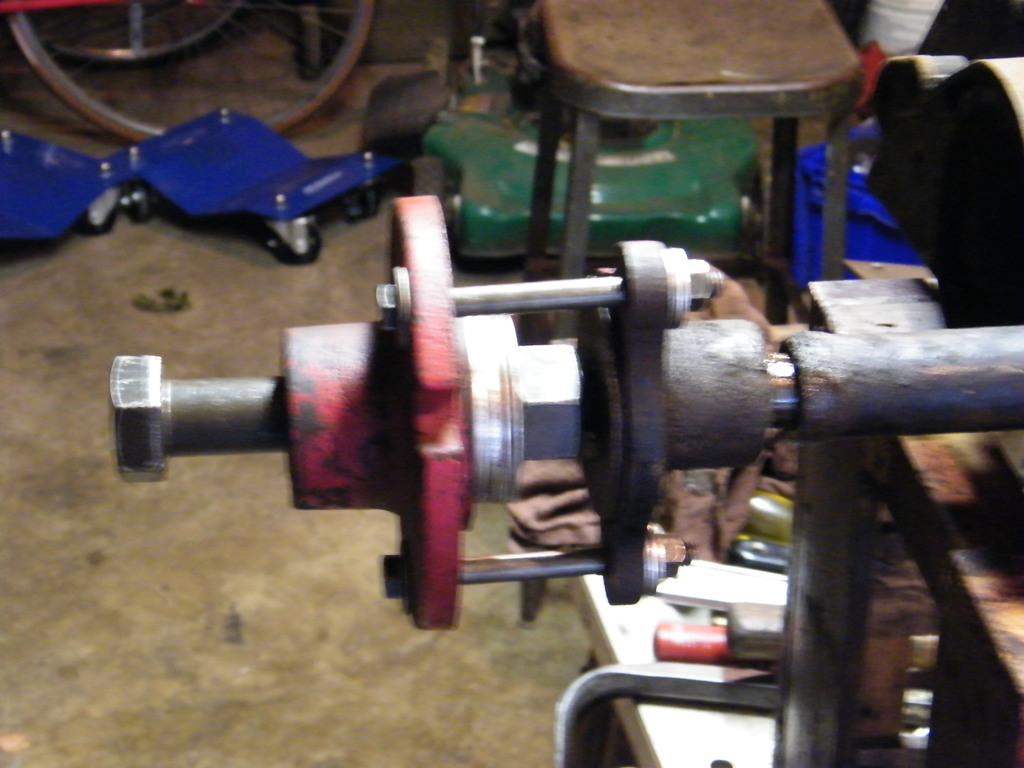

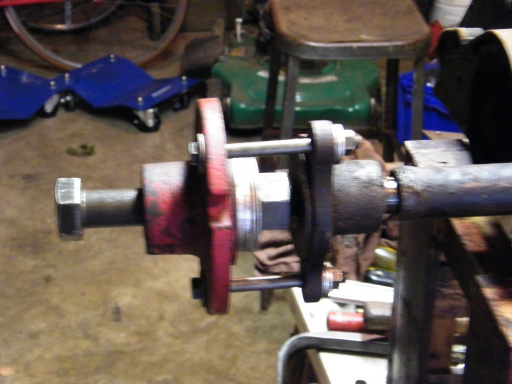

stevasaurus 23,455 #9 Posted February 14, 2017 @Dnorth I got your PM...going to answer here so this will help others and/or others may have another option. For the brake drum...1st, measure the diameter of the drum and the shaft size, I have an extra brake drum if the shaft and diameter are the same size. Take a real good look at that shaft...did you take of the "C" clip that holds it on. A 2' bar behind the drum and a puller like this...should work. As far as the hub...take your other hub and make a puller like this out of it...it will take a hub off... That is a 1" bolt with 1" washers and nut for the center. The other bolts are 5/16 with nuts and washers so as not to mess up the threads in the hub. 3 Share this post Link to post Share on other sites

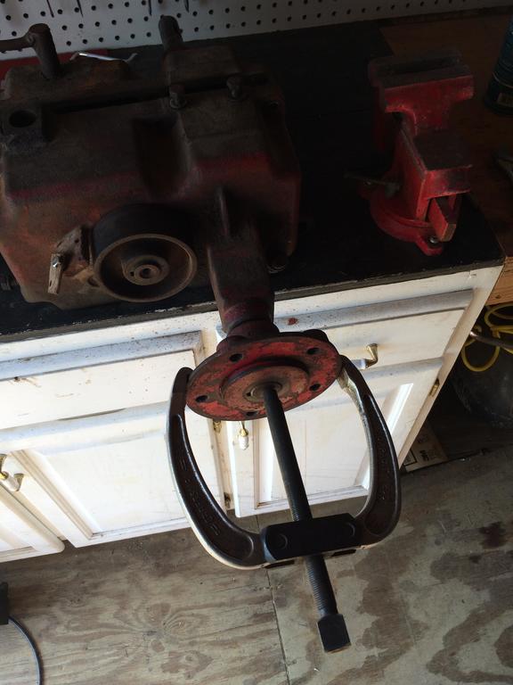

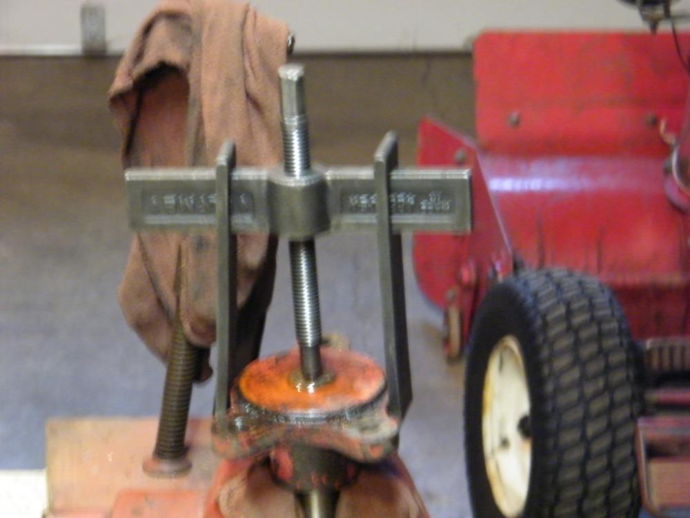

Dnorth 6 #10 Posted February 14, 2017 Thanks, I did take the C clamp off of the brake drum and I'm getting it to budge a little so with a little more work I might can get it off. as for the axle hub, I'll try using the other hub like you did. maybe it will do the trick. This is what I have been using so far to no avail. Share this post Link to post Share on other sites
pfrederi 18,970 #11 Posted February 14, 2017 two arm pullers can break the hub. Also you will notice on the older hubs with the web design for each bolt hole it is not possible to get both arms of the puller on a thick part. Steve's idea of using another hub is best 2 Share this post Link to post Share on other sites
WHX?? 52,898 #12 Posted February 14, 2017 (edited) Be real careful with that puller you WILL break the hub. Sorry there is no easy way other than what Steve showed. Do not hammer on it, there is a retaining ring on the inside of the differential that hold s the axle in, you will break off. Most of us have a few hubs laying around with shot keyways. Might be a member willing to send you one for shipping cost. Edited February 14, 2017 by WHX9 1 Share this post Link to post Share on other sites
stevasaurus 23,455 #13 Posted February 14, 2017 (edited) Right...thanks Paul and Jim. Do not use that puller on that hub...it will break it. I bought my hardware from TSC, they sell their bolts, etc. by the pound. That puller should work on the brake drum though. Close that case up a little to get some room for the arms to catch. Take a wire wheel, file or Emory cloth to clean up the part of the shaft that does stick out. You could use a little heat on the brake drum and then melt some candle wax on it. The wax gets drawn in and works like penetrating oil. On my hub puller, you can tighten up the 1" bolt and then tighten up the 5/16" bolts a little at a time (working your way around). You may have to loosen everything and readjust as it comes off. My picture of that hub puller...I was using that on a 3 hole hub. Make sure you buy the 5 bolts and use all 5 when doing the puller thingy. It will work. Edited February 14, 2017 by stevasaurus 3 Share this post Link to post Share on other sites

stevasaurus 23,455 #15 Posted February 15, 2017 I'm sorry...that was the good hub that broke? I'm looking at the bent bolt at the top of the picture. OMG. Yep, a 4" grinder will cut the hub that is stuck on the axle. Here is a shot of a hub that I ended up cutting to get off...and I still had to use a puller all the way. Sending you a PM. Share this post Link to post Share on other sites

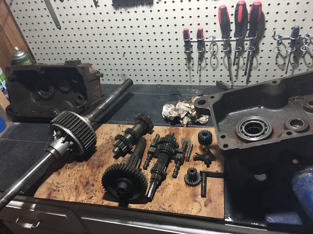

Dnorth 6 #17 Posted June 6, 2017 Well, I have finally been able to get the hub off, and transmission apart but still have to check in the differential gear for any damage. Found new hubs online, got those in the mail the other day, now all i need are new seals for where the axle goes through the side of the transmission. Any suggestions on where to find part numbers for those? Share this post Link to post Share on other sites
