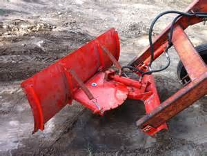

squonk 48,231 #4 Posted September 27, 2016 For my 9000th, here's a pic of a Power King loader arm/ blade set up. May give you ideas: 7 Share this post Link to post Share on other sites

wallfish 20,689 #8 Posted September 27, 2016 Mine resembled the pic Mike posted minus the hydraulics to turn it which is a real nice convenience. It used the loader rams to tilt it up and down but I had to manually angle it. Used a rope to the pin for releasing it and just drove the blade edge into something to angle it from the seat. Sometimes I just had to get my lazy butt off the seat to do it by hand too. Best to keep it as tight to the arms as possible. The farther out it is, the worse the turning radius because you need more room plus the tractor's path gets out of the blade path in tighter turns. Doesn't matter as much if you can just plow in straight lines. Share this post Link to post Share on other sites
rexman72 210 #9 Posted September 27, 2016 2 hours ago, wallfish said: Mine resembled the pic Mike posted minus the hydraulics to turn it which is a real nice convenience. It used the loader rams to tilt it up and down but I had to manually angle it. Used a rope to the pin for releasing it and just drove the blade edge into something to angle it from the seat. Sometimes I just had to get my lazy butt off the seat to do it by hand too. Best to keep it as tight to the arms as possible. The farther out it is, the worse the turning radius because you need more room plus the tractor's path gets out of the blade path in tighter turns. Doesn't matter as much if you can just plow in straight lines. ok great thought on the length of the plow to the arms or bucket. 1 Share this post Link to post Share on other sites
