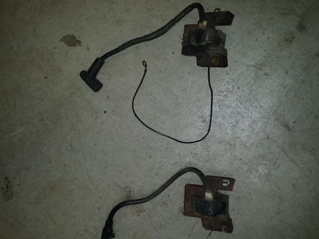

moe1965 774 #7 Posted October 2, 2016 (edited) Here is the latest I think this might be my issue. The coil on the bottom of the picture is the one I had on the engine. The one on the top was in my box of extra stuff I got when I bought the tractor. If the one on the top is the correct one where does the extra wire go. Ground? Or to the ground on the back of the switch? Or neither. There are no points and condenser under the flywheel Edited October 2, 2016 by moe1965 Share this post Link to post Share on other sites
Elkskin's mower junkyard 1,117 #8 Posted October 2, 2016 3 hours ago, moe1965 said: Here is the latest I think this might be my issue. The coil on the bottom of the picture is the one I had on the engine. The one on the top was in my box of extra stuff I got when I bought the tractor. If the one on the top is the correct one where does the extra wire go. Ground? Or to the ground on the back of the switch? Or neither. There are no points and condenser under the flywheel ok i see. some early model magnatron did have a ground wire for one of the bolts the connect mag to block. now extra is kill wire (long) on this one looking at pic both are electronic mags aka magnatron mags Share this post Link to post Share on other sites
oldredrider 2,553 #9 Posted October 2, 2016 The replacement engine (which I think you have) has an on/off switch mounted on the flywheel shroud. It grounds out the ignition via the long wire shown in your picture. If you don't have the shroud switch, you can rig up a simple on/off grounded toggle switch to accomplish killing the engine. This is a cheaper route to take than replacing the ignition switch. Share this post Link to post Share on other sites
moe1965 774 #10 Posted October 2, 2016 Thanks. No more getting shocked while pulling off the spark plug wire. Share this post Link to post Share on other sites
