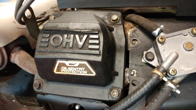

bmsgaffer 2,071 #1 Posted September 26, 2016 (edited) Does anyone know the type of screw that Kohler uses on their shrouds (size, length and head?)? Specifically the ones broken off in the picture below. All of the screws the PO broke off (I have no idea HOW) and I am looking to get the correct replacements without having to pay individual screw prices from Kohler or the like. Thanks! Edited September 26, 2016 by bmsgaffer Share this post Link to post Share on other sites
Achto 32,920 #2 Posted September 26, 2016 I would try to remove the broken bolts to get your size & thread pitch. Most likely 1/4 20 or M6 x 1.0. Instead of buying bolts with a specific head on them just use common headed bolts with a washer & lock washer. Share this post Link to post Share on other sites
Dennys502 246 #3 Posted September 26, 2016 I took a screw out of the shroud - looks to be a m6 x 20mm long. This is a flange head threadformer. 1 Share this post Link to post Share on other sites
