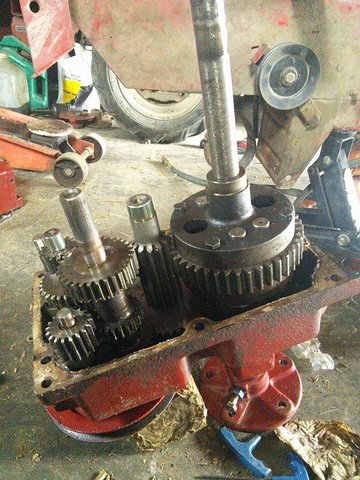

stevasaurus 23,716 #14 Posted September 26, 2016 Scotty...I think it is time we knew what transmission we are talking about. What tractor and model is this in?? I sure hope you are testing this trans before putting it back together again. A couple of pictures would really help. Share this post Link to post Share on other sites
scotty 252 #15 Posted September 26, 2016 (edited) This transmission is out of a 1974 b-80 its a 4 speed. Heres a picture from inside the transmission. Dont mind that part on the axle the bearing i put in fell apart. Edited September 26, 2016 by scotty 1 Share this post Link to post Share on other sites
stevasaurus 23,716 #16 Posted September 26, 2016 (edited) Your differential is upside down...take it out and put the other end in first. Everything else looks good. do you have another gasket?? It is a 4 speed with 1" axles and a 4 pinion differential. Thanks for the pictures...makes things a ton easier. Edited September 26, 2016 by stevasaurus 1 Share this post Link to post Share on other sites

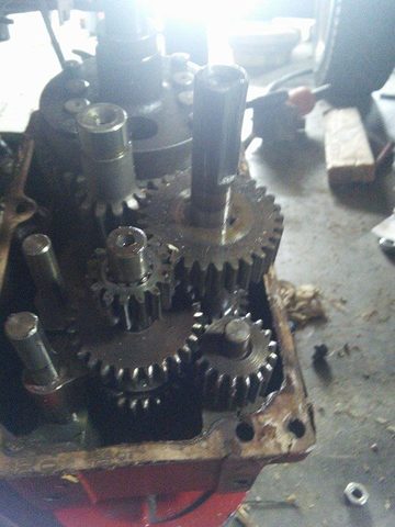

stevasaurus 23,716 #21 Posted September 30, 2016 Scotty, can you take some more pictures. It all looks OK from before, but I can't see a few gears in the pictures you have. Have a look at this thread with the videos...it is the same trans you have. It could be those pictures you have there, the the height of those shafts don't look right either...it could be just the pictures. Share this post Link to post Share on other sites
scotty 252 #22 Posted September 30, 2016 (edited) I found the issue. i must have forgot to put the woodruff key back into the shaft of the inside of the tranny. Easy fix. Edited September 30, 2016 by scotty Share this post Link to post Share on other sites
