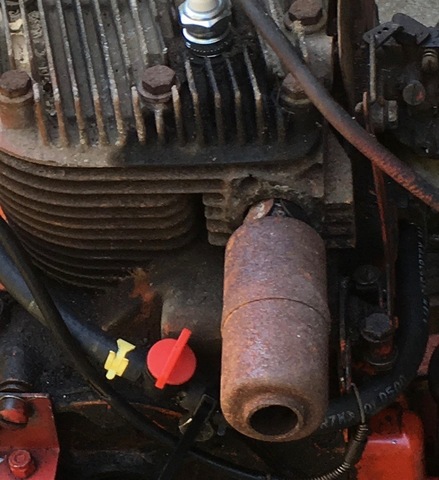

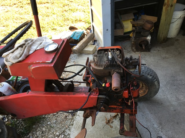

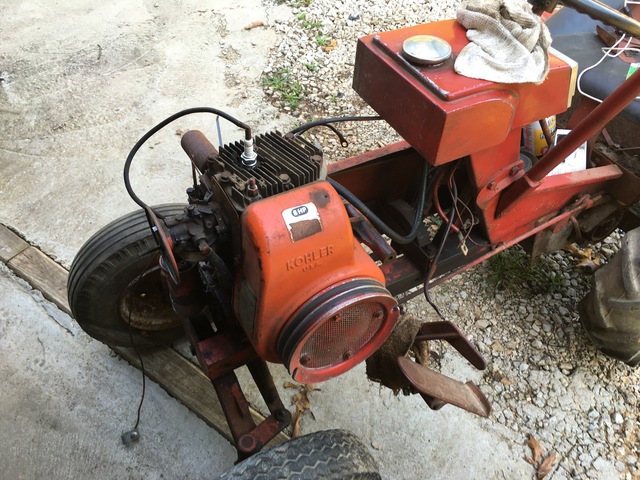

T-Mo-(Moderator) 4,836 #1 Posted September 25, 2016 I picked this 701 up from Steve (wh500special) a couple of weeks ago. I got it running the next day, but today I got it running off the tractor's fuel tank. It has a 8 hp K181 on it now, and it still needs the S/G mounted, and I had to have a bracket made that bolts to the back two head bolts. Right now it just has the cap head bolts, and it needs studs in these two locations to mount the bracket. Muffler is just sitting in the exhaust outlet, which is not threaded but has two threaded holes. So I have to find a gasket and the correct muffler that will mount in those two holes, or make a manifold that will pick up those two holes and then mount a better muffler on that. I'm not sure if I'll keep the 701 and I have my eyes set on a local 753. 9 Share this post Link to post Share on other sites

T-Mo-(Moderator) 4,836 #6 Posted September 25, 2016 One question I do have is on the muffler. The muffler shown is just sitting in the hole, the hole isn't threaded. The picture below you can see it has two threaded smaller holes diagonally opposed from each other. It looks like it might take a pancake style muffler like this: https://www.amazon.com/Kohler-Engine-Muffler-Part--B1SB7727/dp/B01FSYZZS4/ref=sr_1_fkmr0_2?ie=UTF8&qid=1474805575&sr=8-2-fkmr0&keywords=kohler+k181+muffler What other options are there and if that style muffle from Amazon will work and how efficient are those. Share this post Link to post Share on other sites
Retired Wrencher 6,574 #7 Posted September 25, 2016 (edited) T-Mo Looks like a runner. Do start it by rope? I see no S/Gen hooked up? If you can make a manifold for the 2 threaded hole hook up a Nelson to it for a quite ride. Enjoy the project. Edited September 25, 2016 by T1257 RETIRED WRENCHER. Share this post Link to post Share on other sites
T-Mo-(Moderator) 4,836 #8 Posted September 25, 2016 11 minutes ago, T1257 RETIRED WRENCHER. said: T-Mo Looks like a runner. Do start it by rope? I see no S/Gen hooked up? If you can make a manifold for the 2 threaded hole hook up a Nelson to it for a quite ride. Enjoy the project. Yes I rope start it now. I do have the S/G and have the brackets now to mount it. Share this post Link to post Share on other sites

ACman 7,715 #10 Posted September 25, 2016 You can thread your exhaust port with a 3/4" pipe tap . Then you have many options. Share this post Link to post Share on other sites

wallfish 19,723 #12 Posted September 25, 2016 May need a 1" NPT tap. Most of those mufflers are 3/4" NPT so if it's 3/4 and just fits inside, you'll need the bigger tap size. If it is a 1/2" NPT muffler, the 3/4 will work. That cast is fairly easy to cut threads in. Tilt the engine so the exhaust port faces down and use oil on the tap. That will keep the chips from going into the port. I see a 1" tap on epay for $20 1 Share this post Link to post Share on other sites
