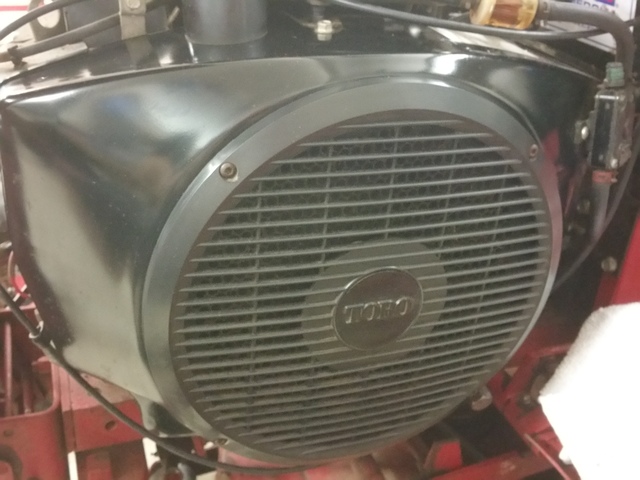

JERSEYHAWG / Glenn 4,580 #1 Posted September 24, 2016 Ok, who has a tip. That 520 plastic is so dam ground in dirty I don't know how to clean it. Trust me, I tried EVERYTHING so far. Glenn Share this post Link to post Share on other sites
slammer302 2,157 #2 Posted September 25, 2016 I like using a cleaner called LA's totally awesome then use meguairs supreme shine. Hope this helps. The LA's totally awesome great for removing grease and oil from a engine best stuff I've found and it's cheap. I buy it at the dollar general store. 1 Share this post Link to post Share on other sites
Wishin4a416 2,604 #3 Posted September 25, 2016 Did you try alcohol [the rubbing kind, not the drinking kind] and a toothbrush? 1 Share this post Link to post Share on other sites
Skeeters65 46 #4 Posted September 25, 2016 Simple Green works well. 1 Share this post Link to post Share on other sites
jdleach 525 #5 Posted September 25, 2016 Glenn, if the grime is at all oil based, such as from hands, petroleum, fried pork chops, etc., try using a bit of regular Go-Jo. A tooth brush, as already suggested, or if you want finer detail, a hog's hair paint brush (see them in paint and big box home improvement stores as chip brushes, have wood handles) can be used to work the Go-Jo in. 1 Share this post Link to post Share on other sites
rmaynard 17,439 #6 Posted September 25, 2016 Depends on the type of plastic and what is on it. If it is smooth plastic, I clean it with a soap like Fantastic, Simple Green of any other spray. Then I use polishing compound. If the stains don't disappear, I spray it with VHT black vinyl dye. When I was restoring black plastic dash panels with white lettering and symbols, I would always coat them with vinyl dye before painting the white parts. Bottom line is, as long as the dirt is removed but stains remain, and you can't get them off, paint over them. 1 Share this post Link to post Share on other sites
JERSEYHAWG / Glenn 4,580 #7 Posted September 25, 2016 (edited) simple green, applied with a toothbrush, a couple of times worked the best. Frankly I never knew you could grind dirt into plastic that deep. Shocked me. This is just one piece, the WHOLE tractor is well, dirty......... Thanks for the tips fellas, another lesson learned. Glenn Edited September 25, 2016 by JERSEYHAWG / Glenn 2 Share this post Link to post Share on other sites
