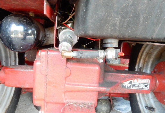

Dball 12 #10 Posted October 5, 2016 Well guys I picked up an airtex fuel pump what's the best location to mount the pump and does any one have instalation/wiring photos thanks again guys and cat wait to see the difference that everyone says it makes Share this post Link to post Share on other sites

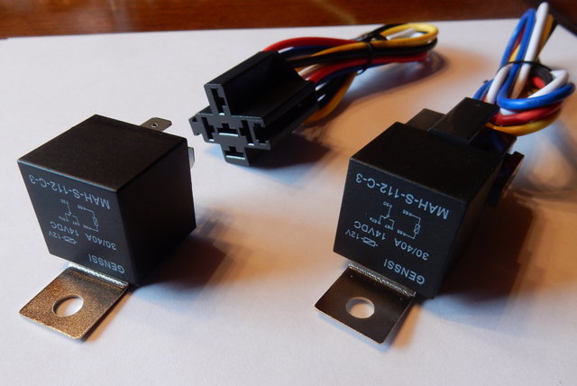

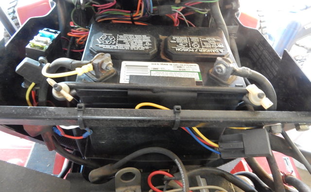

Kurt-NEPA 756 #11 Posted October 5, 2016 The Airtex pump is what I have on my 520H. I mounted it next to and below the gas tank. If you put it there, you will loose the rear lift. The pump should be mounted below the gas tank so that it primes easily, and pointed slightly upward. Make sure to bypass the original fuel pump with the fuel line. I powered my pump using a relay that is fired by the unused terminal on the ignition switch - I think it was the "R" terminal. The terminal is "on" when the ignition is on. When I start the tractor, I turn on the ignition, you can hear the pump start. I wait to hear the pump labor a bit, that means the bowl is full it take less than 3 seconds. Then the tractor starts right up. Here is a picture of my relay. The fuel pump.relay is on the bottom right with the blue yellow and red wires. This relay is a common A/C relay. Note the yellow wire on the battery post, that is the power tap for the pump - running though the fuse on the left. Let me know if you need a wiring diagram and I'll sketch one up. 1 Share this post Link to post Share on other sites

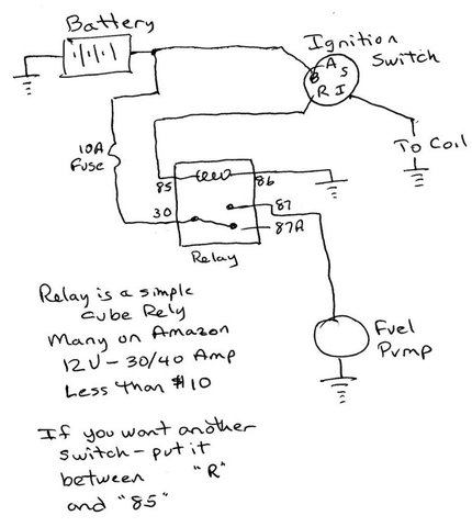

Dball 12 #12 Posted October 11, 2016 That would be great if u could do a sketck Kurt I would like to also add a switch incase I ever need to have the ignition on for any reason so I am able to shut the fuel pump off thank you for the pics as they help alot I will probably have to mount where the old fuel pump was I got my fuel pump from amazon the one u recommend Share this post Link to post Share on other sites
Dball 12 #13 Posted October 13, 2016 Do I have to use a relay when hooking this fuel pump up or can I just use a fuse say 5 amp or so or does it need a relay Share this post Link to post Share on other sites
pfrederi 20,675 #14 Posted October 13, 2016 (edited) I have 3 electric pumps now and i didn't use relays... I wire to the ACC terminal. Pump is a very small draw as opposed to the headlights that are using it. EDIT: Looked up my pump it draws less than 2 amps any ignition switch can handle that Edited October 13, 2016 by pfrederi Share this post Link to post Share on other sites

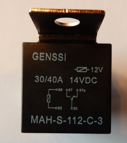

Kurt-NEPA 756 #15 Posted October 13, 2016 Here is the wiring diagram I used on my 520H. I recommend a relay, because I don't like pulling too many amps across the ignition switch. I know some others have simply wired the pump to the I or A terminal on the ignition switch and that seem to work for them. But relays are cheap. I used the R terminal on the ignition switch so that I didn't put a load on the ignition (I) or light (A) circuit. That required a new plug for the back of the switch (Wheel Horse Stable has them) Here is what I used. Less than $10 on Amazon - just search for relays. These are the same relay that WH used on the 520H. There are 3 of them behind the engine. Don't forget a fuse - 10 Amp is fine. Share this post Link to post Share on other sites
