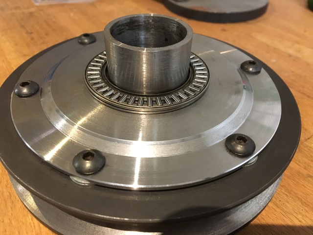

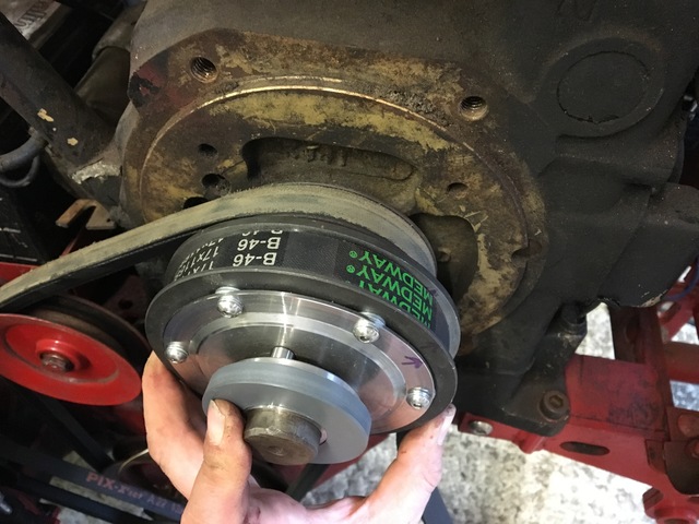

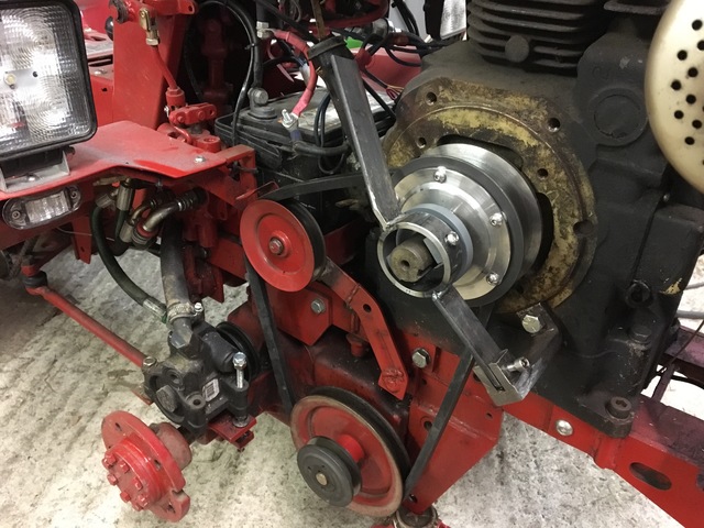

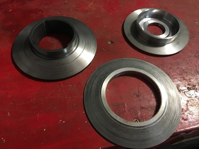

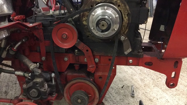

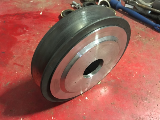

meadowfield 3,174 #1 Posted September 24, 2016 (edited) I've thought of this for a while, it's not a new idea... But will give me shift on the go, and either speed up or slow down if I'm ploughing and need a little more power. Its a variable speed pulley on the engine, giving me around 20% more speed or torque depending how you look at it. Just the actuator lever to sort, before I need to print some 12 speed decals Edited September 24, 2016 by meadowfield 13 Share this post Link to post Share on other sites

jdleach 525 #9 Posted September 25, 2016 Well Meadowfield, been digging around in your variable-V drive drill press? Took me a minute to see what you were doing. Most vari-V drives employ two variable pulleys with some sort of cable arrangement to shift the widths of both pulleys at the same time. I see that you are using an idler to compensate for the changes in pulley spacing. Simple and elegant design. Share this post Link to post Share on other sites
