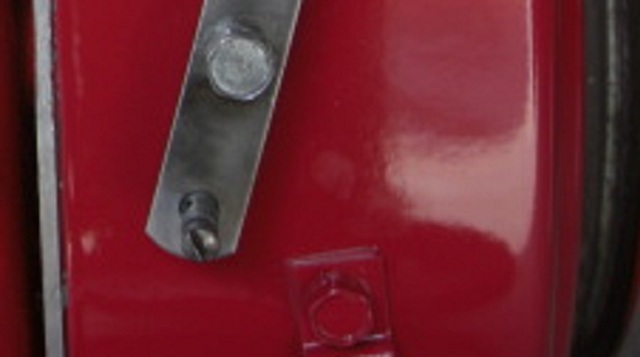

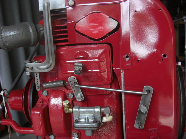

Patrick Reese 40 #1 Posted September 24, 2016 Hi all, I have a 72? No Name with a 12HP Kohler. It is Hydrostatic. Today the end that holds the throttle cable wire just broke off the bracket on blower shroud where it links to Governor. The end is broken off and missing. I can't figure out what it was that was there, but nothing left to put throttle cable end in. Throttle cable was straight and most likely held in by screw that tightened down on cable. Anyone have a manual or a picture of a Kohler 12 from this era so I can figure out what is missing and what I need to do to make it work again? Share this post Link to post Share on other sites
wallfish 20,053 #2 Posted September 24, 2016 Something like this? Share this post Link to post Share on other sites
Patrick Reese 40 #3 Posted September 24, 2016 That is exactly it! It's broken off flush.. looks like it was press fit? Any ideas what to do or where to get that part? Share this post Link to post Share on other sites
wallfish 20,053 #4 Posted September 24, 2016 It's a separate piece. Scroll down the page in this link, second from the last. http://www.psep.biz/store/universal_mower_cables.htm Look on ebay for a better shipping cost. That site is flat rate at $7.95 shipping so it's good to order a bunch of stuff but not good for 1 little part like that Share this post Link to post Share on other sites
