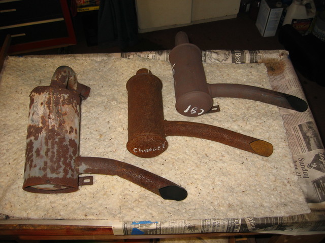

pfrederi 20,247 #5 Posted September 24, 2016 Actually I learned something here. It would appear that the closest thing would be to get a C81 muffler and cut off most of the lead in pipe. The canister and tail pipe are the same. I know the canister on a C160 muffler is bigger around and when i put the 16 hp in my Electro 12 (Blower tractor0 it would not fit under the hood. In the picture C160 on the left Charger in the middle C81 on the right Share this post Link to post Share on other sites
