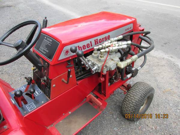

jellyghost 378 #1 Posted September 23, 2016 I ran across these photos, and I was wondering if someone could explain this. In addition, how well would it work? 6 Share this post Link to post Share on other sites
JERSEYHAWG / Glenn 4,589 #2 Posted September 23, 2016 I saw that recently, isn't that for sale currently? Some home made hydraulic rig.. don't know how it would work, but it's interesting, good ol American ingenuity. Glenn 2 Share this post Link to post Share on other sites
jellyghost 378 #3 Posted September 23, 2016 18 minutes ago, JERSEYHAWG / Glenn said: I saw that recently, isn't that for sale currently? Some home made hydraulic rig.. don't know how it would work, but it's interesting, good ol American ingenuity. Glenn Is it for a front loader? Is the engine strong enough to adequately power it? Share this post Link to post Share on other sites
JERSEYHAWG / Glenn 4,589 #4 Posted September 23, 2016 2 minutes ago, jellyghost said: Is it for a front loader? Is the engine strong enough to adequately power it? Jelly, I don't have a clue, you can see time and effort went into it. But I am by far no hydro / pneumatics expert. Drop the guy a line, see what he was thinking, or drinking, or smoking. That is currently for sale though Right? I just saw it within the past week I think. Glenn 4 Share this post Link to post Share on other sites
RubyCon1 63 #5 Posted September 23, 2016 (edited) looks MASSIVELY OVER-ENGINEERED for an attachment lift 10 hp should easily power the system. those poor front wheel spindles ! . Edited September 23, 2016 by RubyCon1 2 Share this post Link to post Share on other sites
857 horse 2,588 #6 Posted September 23, 2016 My head is saying SNOW plow....a small electric winch might have saved days of thought ... i just noticed............2 valves,, hmmmmm. 4 Share this post Link to post Share on other sites
KC9KAS 4,746 #7 Posted September 23, 2016 Someone just wanted hydraulics on their 8 speed Wheel Horse. The 2nd valve may go to a mid (or rear) lift. 4 Share this post Link to post Share on other sites
953 nut 69,073 #8 Posted September 23, 2016 Definite overkill on the hydraulics! I see a tiller on the back with hoses going in that direction and I suppose a blade or small bucket would go on the front. For sure he will have good down pressure! 6 Share this post Link to post Share on other sites
Ed Kennell 47,237 #9 Posted September 23, 2016 May be a lift to make it easy to clean the inside of the deck after mowing. But now it's a 2 day job to check the engine oil level. 6 Share this post Link to post Share on other sites
elliot ness 1,916 #10 Posted September 23, 2016 (edited) I don't have a clue what it all was for, but what ever he or she was building, they did a good job and must have put a lot of thought into it, plus money. Edited September 24, 2016 by elliot ness 4 Share this post Link to post Share on other sites
ACman 7,741 #11 Posted September 23, 2016 I'm with You with 953 , Looks to me he found a Northern catalog and just went over kill on a hydraulic system ! Mobile hydraulic unit for wood spliter , dump cart . Probably fan of Home Inprovment's Tool Time . 3 Share this post Link to post Share on other sites
953 nut 69,073 #12 Posted September 23, 2016 5 hours ago, ACman said: Probably fan of Home Inprovment's Tool Time 5 Share this post Link to post Share on other sites
roadapples 6,987 #13 Posted September 23, 2016 Not sure either, but he definitely knows more about hydraulics than I do.... 2 Share this post Link to post Share on other sites
DougC 2,644 #14 Posted September 23, 2016 8 hours ago, Ed Kennell said: But now it's a 2 day job to check the engine oil level. Do you suppose he went to all that work and didn't modify the tilt hood to a lift off hood?? Share this post Link to post Share on other sites
Ed Kennell 47,237 #15 Posted September 23, 2016 Oh, i'm sure he realized early on Doug that he could not open the hood or use a deck, tiller, blower, or anything that required a PTO or mule drive. Share this post Link to post Share on other sites

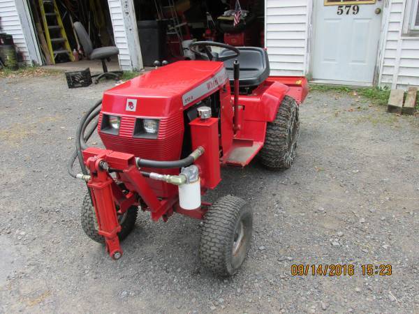

JAinVA 4,638 #16 Posted September 23, 2016 Looks like whoever plumbed this put the filter on the suction side of the pump.Not a good choice.JAinVA Share this post Link to post Share on other sites
cleat 9,324 #17 Posted September 23, 2016 My big diesel tractor is plumbed that way. Filter is more like a fine mesh internally. I believe it is that way because there are several return lines due to numerous valves in the system (loader, 3 point, rear remotes). Share this post Link to post Share on other sites
JAinVA 4,638 #18 Posted September 23, 2016 (edited) Only one return line on that valve.Its the big one outboard side.Most hydraulic systems have the filter in the vavle return line circuit If the strainer on the suction side impedes flow to the pump catastrophic pump damages occurs quickly Edited September 23, 2016 by JAinVA 1 Share this post Link to post Share on other sites
Sarge 3,473 #19 Posted September 24, 2016 Hard telling it's actual intended use , but putting all that hardware on the heat outlet side of the engine is not a good idea for the valve/pump setup nor the engine itself....just saying. Sarge Share this post Link to post Share on other sites
