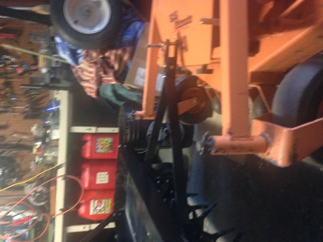

RMiller 13 #6 Posted September 21, 2016 Im not actually sure Im struggling to include a picture! Have it on my iphone at the moment OK I figured it out. Not the best picture in the world Share this post Link to post Share on other sites
bmsgaffer 2,071 #7 Posted September 21, 2016 Oh that model! Every picture I've seen of it running its tilted downwards towards the tractor, it shouldn't affect the operation that much but I know it would bug me too. Don't forget that in operation those spoons should be sunk down in the ground 3 or 4 inches, so that will help things. Share this post Link to post Share on other sites

RMiller 13 #9 Posted September 22, 2016 Thanks for all the answers. My first use did not go all that well. It has been dry in NJ prior to the last few days. Having put down a few inches of water I assumed it was moist enough for aeration but I really wasn't pulling any plugs. So I went back to the installation directions and the final step called for leveling the tray. That only allowed for about an inch and a half unless I replaced the bolts with something longer. I found a welder who is adding a piece to my hitch. I used about fifteen patio blocks for weight wrapped in beach towels to avoid scratching or rattling. At some points the transport wheels were off the ground and I was still getting no plugs at all. Perhaps after all this rain ill have better luck. Share this post Link to post Share on other sites
Tonyp 285 #10 Posted September 22, 2016 (edited) Sounds odd, when I pull the 40, the transport wheels are basically off the ground by 2.5 to 3 inches , I never actually measured. This , with the soil loose and wet, the tines are doing there job with 2 cinder blocks which I am thinking is about 60 pounds. Both the 40 and the 48 are designed to pull a max of a 3" plug with weight in the tray box. My experiences with wet soil is easily 2 to 3 inches across the board based on the lawn. The aerator is leaning forward towards the hitch. The 310 hitch is the same as the 312 hitch, it's the same tractor , maybe post a few photo's of the aerator on the stock hitch. One thing is for certain, DRY soil is very tuff to pull plugs regardless of weight in the tray. As far as scratching and cleaning, as stated earlier, power wash after each use and paint the whole thing . If you don't clean and paint the tines you can count on probably two seasons before they start to rust out and need to be replaced. Edited September 22, 2016 by Tonyp Share this post Link to post Share on other sites

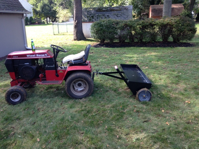

RMiller 13 #13 Posted October 5, 2016 OK Got my hitch welded and ran the aerator last Sunday. Seems to be working fine now. 2 Share this post Link to post Share on other sites
TDF5G 2,074 #14 Posted October 5, 2016 Ya need a cup holder now. 3 Share this post Link to post Share on other sites
RMiller 13 #15 Posted October 5, 2016 Cup holder sounds like a great idea. 4 Share this post Link to post Share on other sites
Tonyp 285 #16 Posted October 6, 2016 It looks good but I am still not sure what was wrong with it being angled down . What was the problem ? Share this post Link to post Share on other sites
RMiller 13 #17 Posted October 6, 2016 Im not sure if the angle down was the problem or it the ground was just too hard when I initially used the aerator. I questioned the angle because the final assembly instruction was to use the tray screws to level the tray. Being level seemed to matter at that point. When the unit was angled I was also offloading patio blocks in the yard as well. That no longer happens. Share this post Link to post Share on other sites
Tonyp 285 #18 Posted October 6, 2016 Thx, I am of the opinion that the angle forward has no effect whatsoever on the actual aerating, as I have been pulling a 40" for easily 8 or 10 years now with no issues. Now, the patio blocks, sure if they are stacked and the aerator is leaning forward, yep they are going to slide off. They will probably slide off anyway just from the bumpy ride. Maybe try a couple of cinder blocks which is approx 60 pounds. Trying to aerate on HARD soil is pretty much not going to happen unless you are using a very big tractor with the aerator on a 3-point hitch . glad it's all good for you now. Don't forget to power wash the aerator and paint the weight box and tines when you are all done. Share this post Link to post Share on other sites
