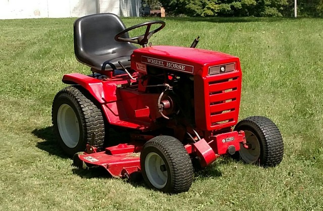

bpope 0 #1 Posted September 20, 2016 I have a C120 8 speed. ID tag says 61-12k802-10819 . 6029 Looking for year. Also wondering what models and size of deck it takes? What model of snowthrower and tiller? Share this post Link to post Share on other sites
Don1977 605 #2 Posted September 20, 2016 (edited) 1976 Edited September 20, 2016 by Don1977 1 Share this post Link to post Share on other sites
Sparky-(Admin) 24,986 #3 Posted September 20, 2016 Like Don said its a 1976. It'll accept a 36" rear or side discharge deck, a 42" rear or side discharge deck and will also spin up a 48" deck. Any tiller or snowblower made from 1973 and newer that's for the attach-a-matic garden tractors will work. Mike.... 1 Share this post Link to post Share on other sites

TIGman 2,006 #7 Posted September 22, 2016 to I believe that your questions about the C-120 have already been answered. But I can tell you that they are a nice tractor. . I have a 1977 with a 42" deck. 3 Share this post Link to post Share on other sites
Tonyp 285 #8 Posted September 23, 2016 (edited) great machine, if you think about it, ALL of the Garden tractors ATTACH-A_MATIC accessories will work just fine with this series, Following the C series the Garden Tractors just changed the Series name motor sizes and some tranny's. the frames and decks were the same. The hoods were different and the decals were different but the tractors were pretty much the same and the attachments were universal. Your C Series, my 1987 /310 and my 2004 315-8 are basically the same. As long as the decks have the appropriate LIFTS on them you will be good to go. 37,42,48 As stated above, plows and tillers which use the attach-a-matic system are what you want. Lets see a photo ! Edited September 23, 2016 by Tonyp Share this post Link to post Share on other sites
