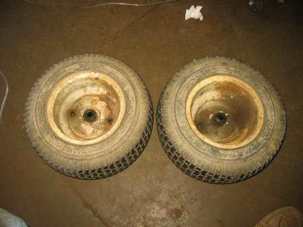

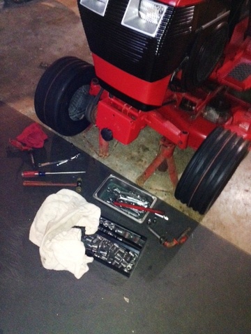

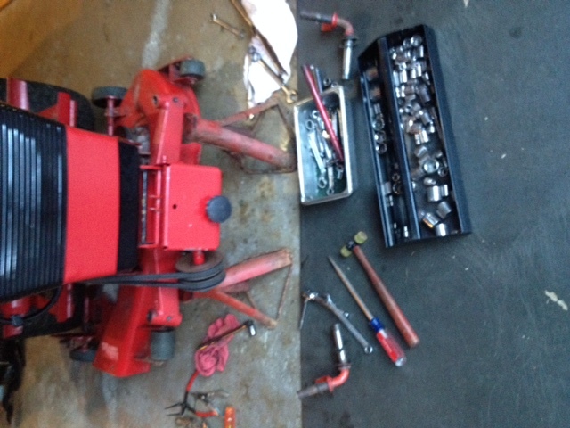

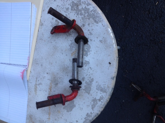

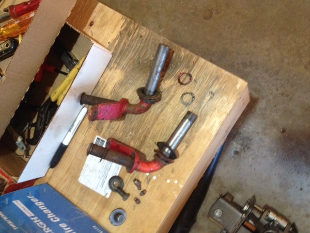

Cadmandu 67 #85 Posted September 29, 2016 I am 66 so remember that very well. Patching tubes as a kid was big on my list vulcanizing and all. I was just not expecting to find this still going on today. The tires were pretty expensive and the 35.00 tubes did not help. I got my 8" spindles yesterday. Got the 6' off and will be putting the 8" on if the used 8" rims and tires come tonight. I bought them off of Dave Luzier very nice guy meet him on red square. The 8" are on the wood and the 6" on the white table these are the wheels that are coming soon. Here is a spacer I designed if needed. wheel_horse_spacer.pdf Share this post Link to post Share on other sites
