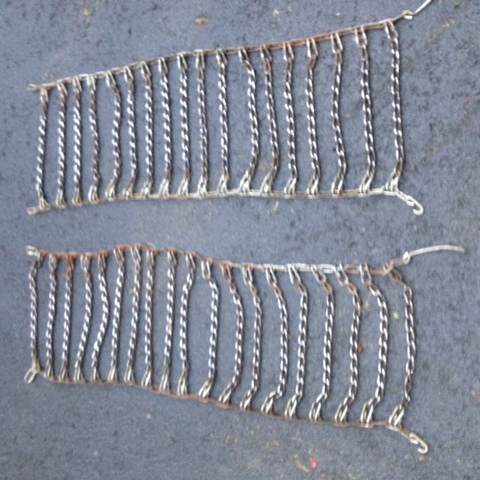

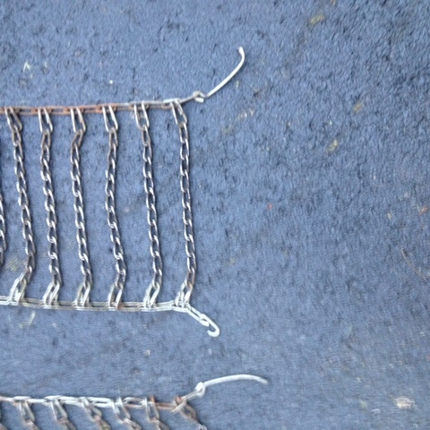

Cadmandu 67 #35 Posted September 19, 2016 Got the belt back on real easy when you do it correctly. Sorry for being so lame. I found a set of weights will these fit my horse. http://pittsburgh.craigslist.org/grd/5788102389.html 2 Share this post Link to post Share on other sites
shallowwatersailor 3,221 #36 Posted September 19, 2016 (edited) 1 hour ago, Cadmandu said: Got the belt back on real easy when you do it correctly. Sorry for being so lame. I found a set of weights will these fit my horse. http://pittsburgh.craigslist.org/grd/5788102389.html Yes, those are one of the best type to get. Good price for chains, they look like two-link as well , and weights too. I couldn't measure the backset on the wheels of my 312A but the spacer is 1/4". Edited September 19, 2016 by shallowwatersailor Share this post Link to post Share on other sites

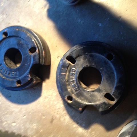

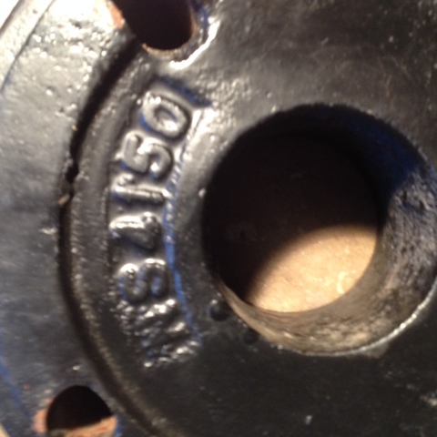

Cadmandu 67 #38 Posted September 20, 2016 Just got back picked up 70 lb wheel weights and chains for 150.00. http://www.tractorweightsonline.com/tractor_wheel_weights/details.php?weight=4150 Chains are 50 x 15 Hi BMS my son lives in Cincinnati. What i meant was the grass shut that attaches to the 37" deck. It came with a bagger and no shut. I noticed my blades had a 1" high 90 degree lip on them is that for mulching or creating a better suction for the bagger. I noticed that my air valves are on the inside of the rim o the backset side not out front. I'm working on a set of 8.5 wide rims with a 1 3/8 backset. The guy at the used tractor store took back the cub wheels and will remove a set of wheels from a H420 on Tuesday 1 Share this post Link to post Share on other sites
bmsgaffer 2,071 #39 Posted September 20, 2016 Gotchya! You may be able to post in the "Wanted" classifieds to see if someone has one to sell ya. And also, all WH's since VERY early on have run the fill valve on the inside of the rims front and back. Your fronts may be on backwards (If I understood you correctly) At first it seems like a pain in the neck, but you get used to it and its nice when wheel weights are mounted. Share this post Link to post Share on other sites
Cadmandu 67 #40 Posted September 20, 2016 That is some more really good rim info. Now I know if the backset is not 1 3/8 and the air valve hole is not on the inside this is not a WH rim. Please explain this. The tractor guy Harrry told me last night that WH had silver rims and white rims and they were different and I guess older and newer models. My weights don't seem to fit inside the rim very deeply should they? Share this post Link to post Share on other sites
