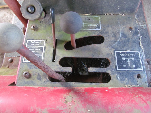

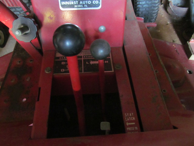

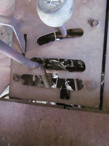

Ed Kennell 43,379 #1 Posted September 11, 2016 I have had a '70 raider for several years and I see it has a #5073 8 speed. The '80-'84 C 105 I picked up Thursday has a #103916 8 speed. The '77 C-160 I got yesterday has a # 5091 8 speed. Can anyone tell me the difference and which one is the strongest? Also noticed the shift lever cover plates are different. The Raider..no cover The C105.....normal And the C-160.....what was the x-tra notch for between reverse and first? I may have figured it out while looking at the picture. Was it for clearance to get the plate off the shifters? Share this post Link to post Share on other sites

slammer302 2,156 #6 Posted September 12, 2016 The Raider 10 should have the 10 pinion limited slip trans but in most I've had the limited slip doesn't work because the mechanism is broke inside. The notch by the shifter is for a latch on the models that had the seat pan that raises. 2 Share this post Link to post Share on other sites
