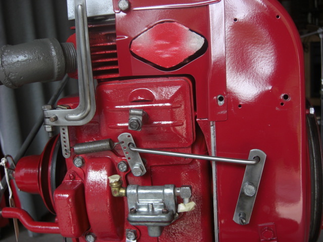

Retired Wrencher 7,034 #1 Posted September 10, 2016 (edited) Well after some good help from our members. This is what I have. Not sure of the spring ? This has been apart for about 4 to 5 years not sure if was even there? this is basically a new engine never been ran. Thanks again for the help. Edited September 10, 2016 by T1257 RETIRED WRENCHER. Share this post Link to post Share on other sites
wallfish 20,733 #2 Posted September 10, 2016 That's how it should go. What about the spring are you not sure of? Share this post Link to post Share on other sites
Retired Wrencher 7,034 #3 Posted September 10, 2016 John I found it in my parts bins it looks right but not sure I may just order one to see if this the right one. Thanks for the post. Share this post Link to post Share on other sites
Wishin4a416 2,610 #4 Posted September 11, 2016 Shouldnt there be a throttle stop behind the middle linkage bar? Both the 14 and 16 I redid had them. I adjusted to only get 3600 RPM. It is a little piece of angle that bolts behind the middle linkage bar. I will include a pic but it is very hard to see it it is behind the silver bolt head right above the fuel pump. Share this post Link to post Share on other sites
Retired Wrencher 7,034 #5 Posted September 11, 2016 9 hours ago, Wishin4a416 said: Shouldnt there be a throttle stop behind the middle linkage bar? Both the 14 and 16 I redid had them. I adjusted to only get 3600 RPM. It is a little piece of angle that bolts behind the middle linkage bar. I will include a pic but it is very hard to see it it is behind the silver bolt head right above the fuel pump. Jack you mean the L shaped bracket? Is that on your valve box cover?. Share this post Link to post Share on other sites
Wishin4a416 2,610 #6 Posted September 11, 2016 No. I will try to get a better pic today. Hers the best I can do. I hope it helps. I considered it a throttle stop. It is small. Only about 3/4x3/4x1/2 wide. Share this post Link to post Share on other sites
Retired Wrencher 7,034 #7 Posted September 13, 2016 Ok Thanks Jack I will look around and see if I have one. I do have some thing like that but longer. Share this post Link to post Share on other sites
