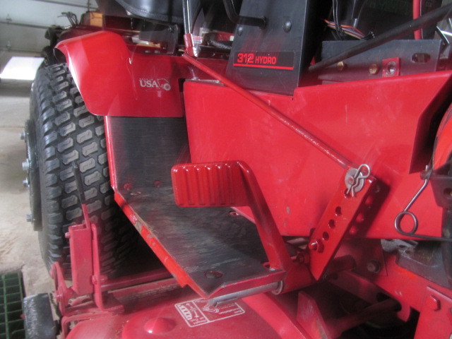

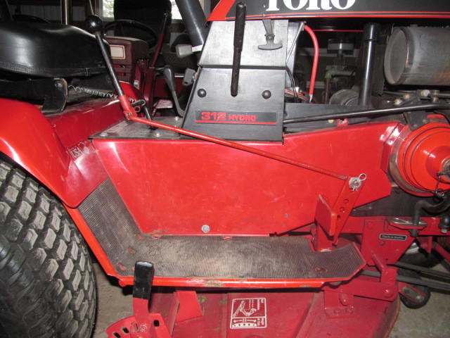

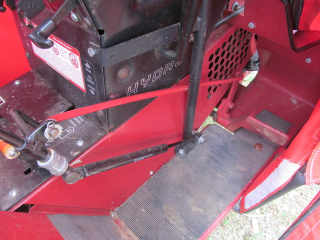

Ed Kennell 47,105 #17 Posted September 9, 2016 When I buy any hydro, my first test is to chain it to a tree and make sure it will spin the wheels through the full range of forward/reverse motion. I have even tested non running tractors by taking the seat/fender pan off so I could drive the hydro with a long belt and another tractor for the test. I would never say anything bad about Matts foot control as by the testament of many on here, He makes a fine product. But, I must say the Redneck foot control I have put on my 520 and 312 is perfect for me. One spring loaded right pedal gives full range of forward/reverse control. Push down for forward and allow the spring to raise the pedal for reverse. With a little practice, it is very easy to stop at the neutral position. If you must stop quickly, simply push the left brake pedal which forces the motion control to neutral and applies the brake. The right hand stays on the steering wheel and the left hand stays on the hydraulic lift. No lost motion due to changing gears or switching hands or feet to different levers or pedals. 3 Share this post Link to post Share on other sites
