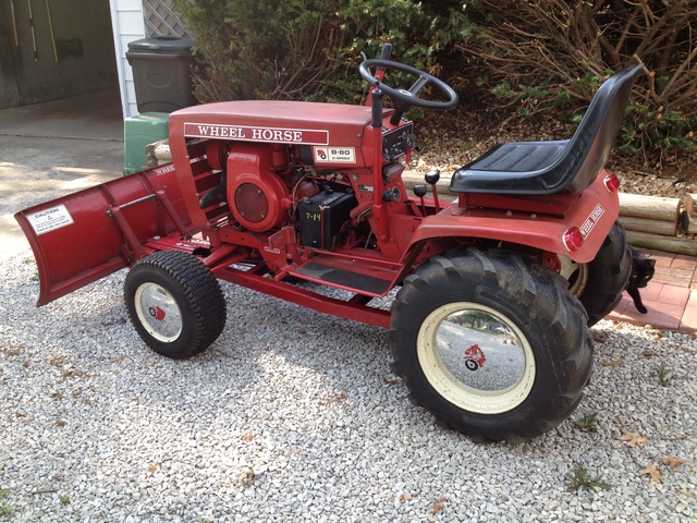

scotty 252 #4 Posted September 7, 2016 I agree i put the 23x8.50-12 ag tires on my b-80 with the 4 pinion there's nothing that it cant do compared to an 8 pinion. 1 Share this post Link to post Share on other sites

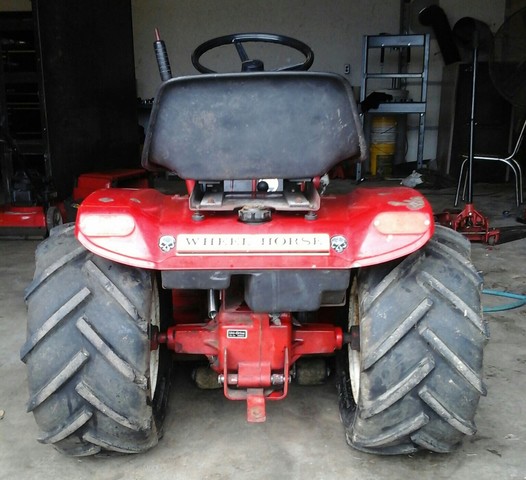

Dan Hankins 80 #10 Posted September 8, 2016 23x10.5x12 on my sk486 3 Share this post Link to post Share on other sites
TDF5G 2,074 #11 Posted September 8, 2016 (edited) On 9/7/2016 at 0:49 PM, scotty said: I agree i put the 23x8.50-12 ag tires on my b-80 with the 4 pinion there's nothing that it cant do compared to an 8 pinion. I did the exact same thing. I have much better traction when mowing on the hills in my yard. These are 23x8.50 Carlisles. As far as changing tires, it's a chore and will require some effort without a tire changer. You can do it yourself with a couple of tire tools. If the beads are rusty and stuck you'll be cussing it before your done. I've broken down beads with a bottle jack under the bumper of my pickup truck. There are other methods also. I would recommend watching some videos on youtube to see how it's done, then decide if you want to tackle it yourself. Edited September 8, 2016 by TDF5G 2 Share this post Link to post Share on other sites
