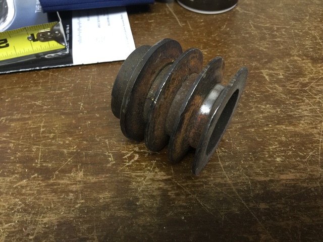

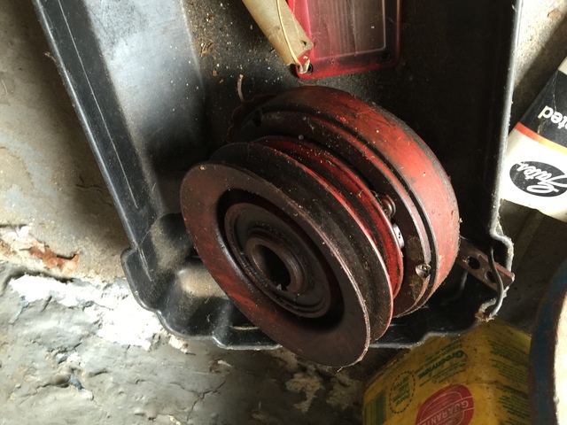

RJR49 161 #7 Posted September 7, 2016 Sorry, it's a 1975 old school. points plug , condenser, and coil BTW I'm going to post this over in classifieds but anyone wanting either of these can have them for the postage. The pulley is the engine pulley from either a 1045 or a 1075. I think The clutch is off an Electro 12. It may have been rebuilt at least once. Share this post Link to post Share on other sites
