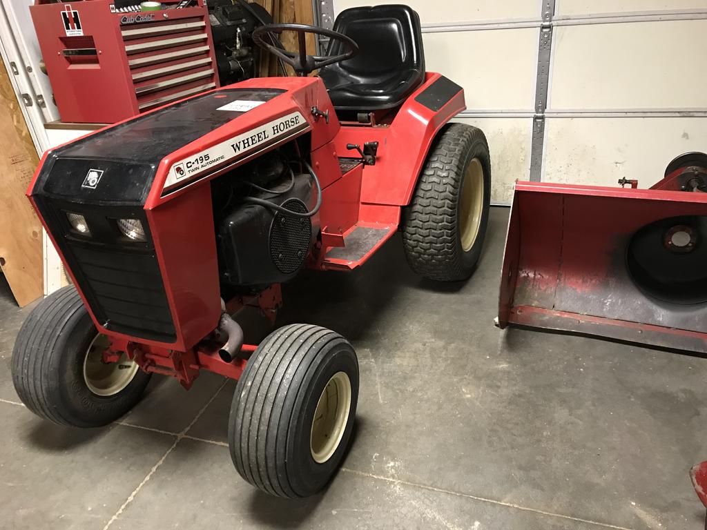

PeacemakerJack 10,873 #20 Posted January 5, 2018 Hey @Sarge just found this thread! Pretty cool because I want to put a 3pt on my C195. I have the lower arms and the lift links, just need to fabricate the upper lift arms and Connect a ram. To answer your question the C195’s have a dual spool valve. One for the rock shaft and one for the three point... Zoom in on this pic and you’ll see the two levers just above the tunnel Share this post Link to post Share on other sites
Sarge 3,470 #21 Posted January 5, 2018 Ah ,as I thought . I knew there was another model besides the D series that had a twin valve setup , good deal . Now , I really want to hunt one down , lol... Sarge 1 Share this post Link to post Share on other sites

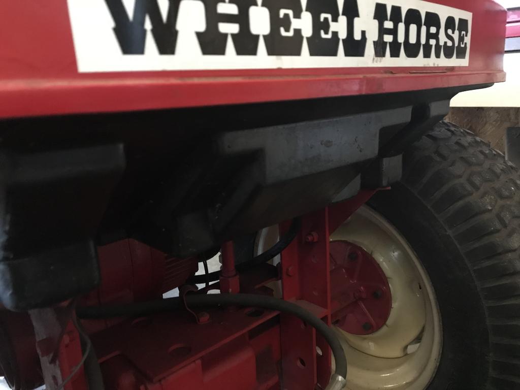

953 nut 64,299 #22 Posted January 5, 2018 Is your fuel tank set up for the three point? Share this post Link to post Share on other sites
PeacemakerJack 10,873 #23 Posted January 5, 2018 Looks like it! 1 1 Share this post Link to post Share on other sites
