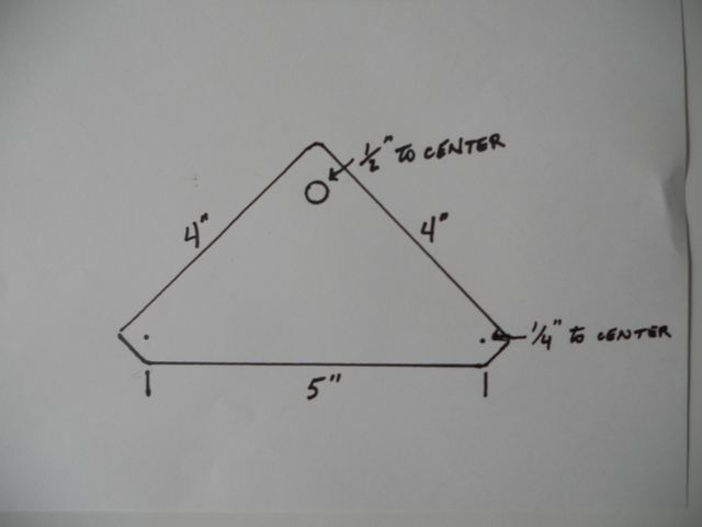

elcamino/wheelhorse 9,363 #1 Posted September 3, 2016 Can some one give me the measurement of the triangle do hickey on a 42 inch snow plow. All I need is the approximate sizes of all sides and the measurement of the top hole from the top of the triangle. I can not find the original , I know it was in the box of parts when I started working on the plow but it has grown feet and moved to a hidden location and I am tired of looking for it. Thanks Share this post Link to post Share on other sites
Racinbob 13,213 #2 Posted September 3, 2016 Here you go Jim. The plate is 3/16" thick. 4 Share this post Link to post Share on other sites
elcamino/wheelhorse 9,363 #3 Posted September 3, 2016 Thanks that just what I needed . Now to find the piece of metal I found to make it. My shop is so full I have to back out the door to turn around. 2 Share this post Link to post Share on other sites

98layinframe 23 #19 Posted November 24, 2016 I love this forum! it takes awhile to find stuff, but eventually find it! Anyways, I'm missing this exact triangle piece.. my question is on the drawing are the 4" and 5" measurements the outer corners of the piece itself, or the center to center measurements of the holes themselves? Share this post Link to post Share on other sites
Racinbob 13,213 #20 Posted November 24, 2016 It's the overall measurement of the plate. The 5" is between the lines. It does look like I was showing the c/c of the holes but that wasn't the intent. Share this post Link to post Share on other sites
98layinframe 23 #21 Posted November 24, 2016 Ok thanks for the quick response, any chance you would know the center to center measurements and hole sizes? Share this post Link to post Share on other sites
Racinbob 13,213 #22 Posted November 24, 2016 The larger hole is 1/2" in from the edges to center. The two smaller are 1/4" in to center. Size them according to the rod size. Share this post Link to post Share on other sites
