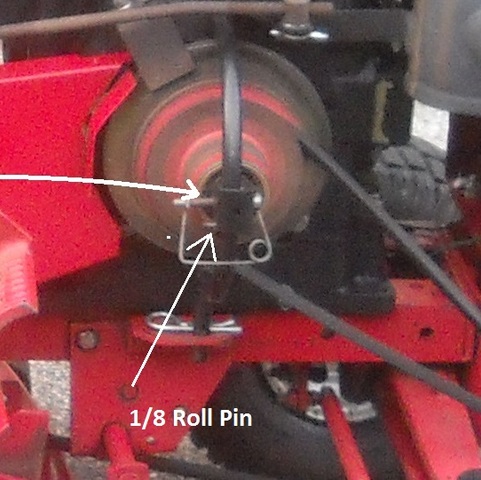

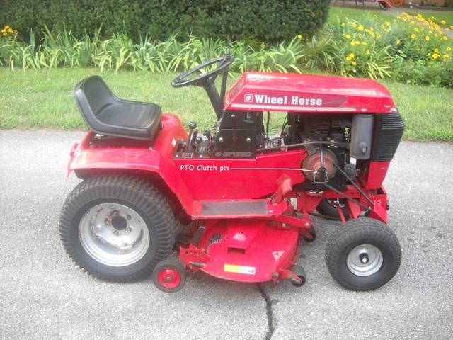

953 nut 69,073 #2 Posted September 2, 2016 (edited) Did you remember to install the pin that connects the tensioner to the end bell? Edited September 2, 2016 by 953 nut add photo Share this post Link to post Share on other sites
wallfish 20,575 #3 Posted September 2, 2016 Probably best to post a pic of your PTO for better and quicker internet diagnostics. Other than that, it's just guessing but I'll take a stab at it too. Check that little 1/8 inch roll pin too which that piece swivels on. Common for them to wear, rust and break. Share this post Link to post Share on other sites

Anglo Traction 761 #5 Posted September 3, 2016 Just a hunch......... I reckon the Snap Ring on the Clutch Stub Shaft may have jumped out of the Groove?. The Shaft is the one that the PTO Clutch Pin shown in Richard's (953 nut) above passes through. If it is the worn groove in the Shaft, the part number is 102872 and available all over the internet (search for Toro 102872).....probably need to replace the Snap Ring as well. If is not the cause, or any of the other suggestions , I have no idea what else it can be?. Regards Share this post Link to post Share on other sites
jdleach 525 #6 Posted September 3, 2016 HEY! I thought that machine looked familiar. THATS MY TRACTOR! The WH PTO clutch is a very simple mechanism, and can be pretty thoroughly worn out and still work. I just placed an order for almost every PTO part on my C-175 black hood. The trunnion had serious grooves cut into it, the clevis, (center part with the roll pin) had the holes severely wallowed out, and the PTO brake was missing entirely. That said, it would still engage. Be aware, that even in "new" condition, the PTO linkages are pretty loose. There is ample clearance between bolts, pins, and holes so that the parts "float", but will find their respective positions whenever the lever is engaged. Share this post Link to post Share on other sites

953 nut 69,073 #9 Posted September 3, 2016 3 hours ago, jdleach said: THATS MY TRACTOR! It was quicker to go to the gallery for a photo than taking the camera out to the barn! Yours is prettier than mine anyway. 1 Share this post Link to post Share on other sites
