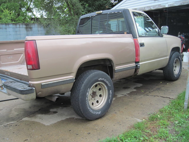

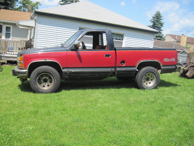

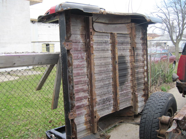

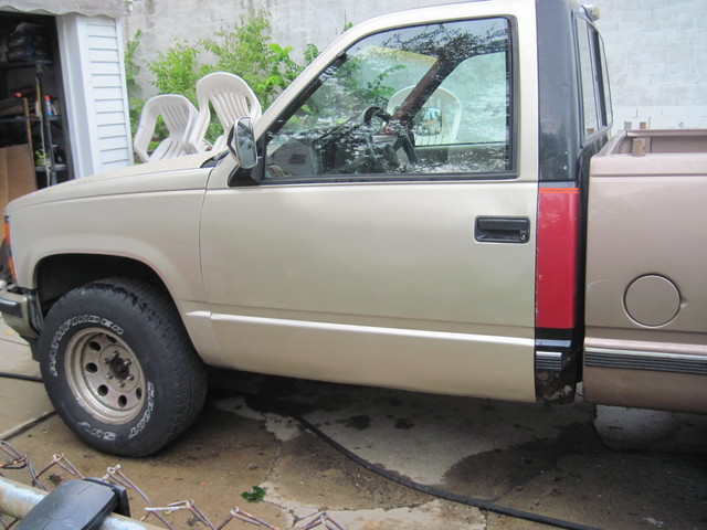

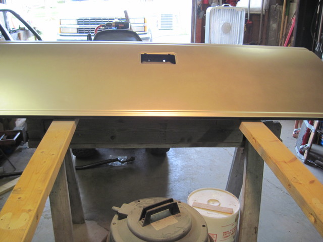

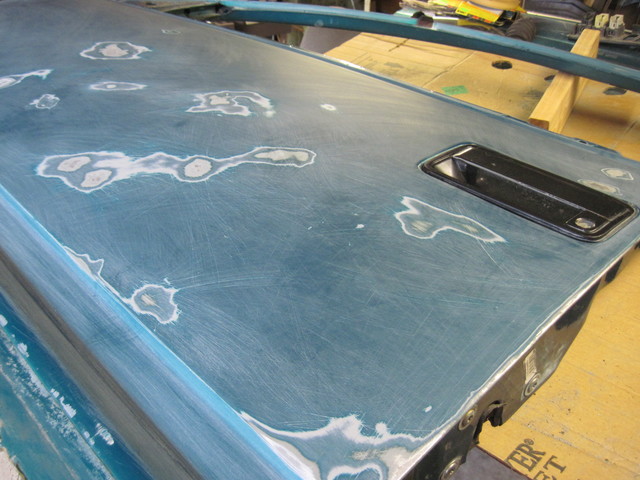

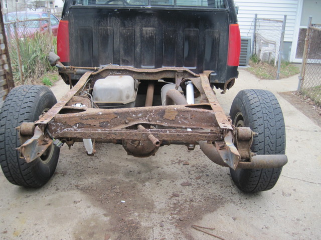

Walt 339 #18 Posted September 10, 2016 On 9/2/2016 at 5:29 AM, 857 horse said: Like you approach...Goo Gone works,,, Can we see.??? Good Luck !!! Sorry I meant to do this sooner but here are pics for ya. First couple are my ugly ass truck last year and the Walnut tree stump I pulled with it. Then this spring I snapped all the mounting bolts and pushed the box off frame to replace it. Lastly are the doors and fenders I replaced in last couple of weeks and tail gate I decided to paint since when I bought it and box it was blue. Looking for cab now to prep paint and change next spring. 3 Share this post Link to post Share on other sites
