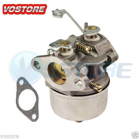

gtofani 36 #1 Posted August 30, 2016 I am looking for a place to buy a carburetor rebuild kit for my 1967 wheel horse with a Tecumseh engine. It fires right up with the instant start but is not getting fuel. I figure a carb rebuild would help. Does anyone know a part number or place where I can locate one? Share this post Link to post Share on other sites

AMC RULES 37,259 #3 Posted August 30, 2016 Great running, brand new, knock off carbs... can be found for less than $10, all over Ebay. I would suggest obtaining yours from a US based supplier though. 1 Share this post Link to post Share on other sites
gtofani 36 #4 Posted August 30, 2016 how will I know it fits my engine? or are they pretty much all the same. Share this post Link to post Share on other sites

stevasaurus 23,834 #7 Posted August 30, 2016 (edited) See...I guessed wrong. You should have the H60...either 75118F or 75117F. Let's see what we can find. check out this manual. Check out the blow-up and item #290...says the carb is #631067A. Looks like it would be for either Lawn Ranger. I don't know if that # is a Wheel Horse or Tecumseh number though. Edited August 30, 2016 by stevasaurus Share this post Link to post Share on other sites
pfrederi 21,136 #8 Posted August 30, 2016 (edited) Carb kit is Tecumseh 31840. Oregon after market. 49-840 Check that the wiremesh screen in the tank isn't clogged. https://www.rcpw.com/search/?quest=31840 Edited August 30, 2016 by pfrederi 1 Share this post Link to post Share on other sites

gtofani 36 #10 Posted August 30, 2016 found it and ordered it, only 13.99 and that is including shipping. great deal. thanks all. 3 Share this post Link to post Share on other sites
