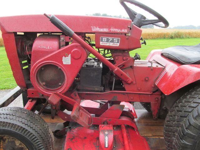

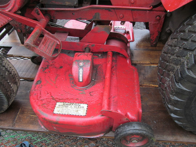

kudzu3 323 #1 Posted August 27, 2016 A fellow red sq member near me has asked for my assistance in installing a mower deck on her 855. I have searched the web for schematics or direction to help with this project, thus far, I can't find anything. I believe the job will be a simple one and can probably be done without a picture, but it would help. Can anyone point me in the right direction ? Thanks Share this post Link to post Share on other sites
Ed Kennell 46,244 #2 Posted August 27, 2016 Does this help? Should be the same as an 875 1 Share this post Link to post Share on other sites

squonk 46,895 #5 Posted August 27, 2016 I always connect the lift rod to the bell crank first . Lift the deck and then slip the front shaft into the mid hitch and lock it. I also insert a hairpin clip into the hitch so it won't accidentally open. Share this post Link to post Share on other sites
