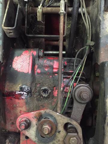

TimH 105 #1 Posted August 27, 2016 Is there a way Or what's the best way to get Hydro trans to release so it can be loaded on a trailer Engine is blown Share this post Link to post Share on other sites
scotty 252 #2 Posted August 27, 2016 If it has the eaton 1100 there is no tow valve on them. If it has a sunstrand there should be a tow valve. The tow valve on the c 160 i have is on the left side of the transmission. 1 Share this post Link to post Share on other sites
953 nut 70,056 #3 Posted August 27, 2016 Tow valve on the Sunstrand is under the seat to the left. 1 Share this post Link to post Share on other sites
TimH 105 #4 Posted August 27, 2016 Looks like I will have to get a tow motor to put on trailer Share this post Link to post Share on other sites
Ed Kennell 47,749 #5 Posted August 27, 2016 Do not force it by towing, but you should be should be able to push the Eaton. Just do it slowly and it should move. Share this post Link to post Share on other sites
oldredrider 2,554 #6 Posted August 27, 2016 Move the directional control lever full forward. It should move then, but slowly. Share this post Link to post Share on other sites
woodchuckfarmer 333 #7 Posted August 27, 2016 If its a 700 eaton you cant push them at all. 1 Share this post Link to post Share on other sites
Detector 72 #8 Posted August 28, 2016 I can push my WH with the Eaton 1100 slowly with ease but as stated above with the motion control lever "full forward", the previous owner pushed it in neutral not knowing but seems no harm was done over the years Share this post Link to post Share on other sites
TimH 105 #9 Posted August 28, 2016 18 hours ago, woodchuckfarmer said: If its a 700 eaton you cant push them at all. Sorry guys WH will not move. Any way we try. Fork lift time , Strip it out for parts a I might need in future. Scrap the rest. Thanks for trying 700 is a big mess from WH Share this post Link to post Share on other sites
