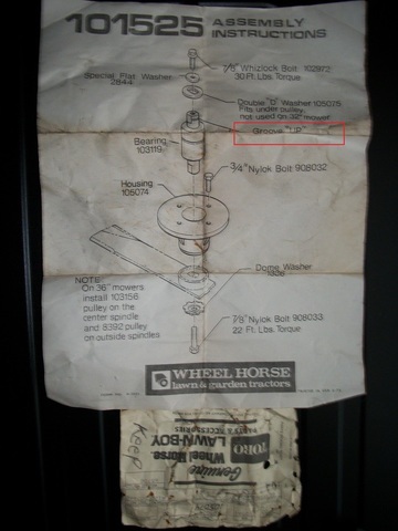

Vrocko 0 #4 Posted August 27, 2016 Sorry Daveoman1966 the site would not let me respond. It's a 36 deck. It's cast iron. I got the sleeve out of the spindle. How do I go about removing the bearings.Heres a pic. Share this post Link to post Share on other sites
gwest_ca-(File Mod) 11,518 #5 Posted August 27, 2016 That looks like the 103119 bearing that Toro no longer carries. Still available from others including Napa https://www.rcpw.com/search/?quest=103119 It comes with the shaft. Check a parts list if you know the model number of your deck. Garry 1 Share this post Link to post Share on other sites
daveoman1966 3,841 #6 Posted August 27, 2016 EBAY HAS THEM TOO.. JUST SEARCH ON BEARING 103119. AROUND $40 BUX EACH...;SET OF 3 FOR $80 OR SO. THERE IS A RIGHT AND WRONG WAY TO PRESS THE BEARING BACK INTO THE HOUSING....NOTE THE LOCATION OF THE "RING-AROUND-THE BEARING". iT MUST BE ON THE TOP SIDE OF THE HOUSING 1 Share this post Link to post Share on other sites
